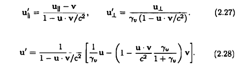

Taken from Steane's "Relativity made relatively easy" equation 4.8
I have been trying to show (4.8) using these relations earlier on in the book:
Tried most means (rearranging, taking dot products) but can't seem to make it work. Is there an easy method I'm missing out?

I'm trying to derive eq 4.8 starting with the ones below, 2.27 and 2.28.
Then expand all 3. The point is to get them all into the same form.

Just expand it. I don't know why you keep on saying that you don't know what the RHS of 4.8 is. u' and v are vectors, just write them as components and expand in the basis where x is the parallel direction.
I believe unscientific doesn't want to manipulate the RHS of 4.8 because he considers that he isn't supposed to know what it is before deriving it from 2.27 and 2.28 in the first place.
@unscientific: even though you want to derive 4.8 directly from the other two equations, expanding 4.8 will help you understand how you can do that, because some steps may not be obvious. Then you can do the whole derivation starting from 2.27 and 2.28
It may help to note that the parallellity (is that a word?) and perpendicularity are with reference to the relative velocity of the moving frame. In that case, u.v=u||×v + u×0.
Start from:
[itex]\frac{1}{1 - (u \cdot v)/c^2 } = ...[/itex]
and you will reach the result. It's straightforward.
