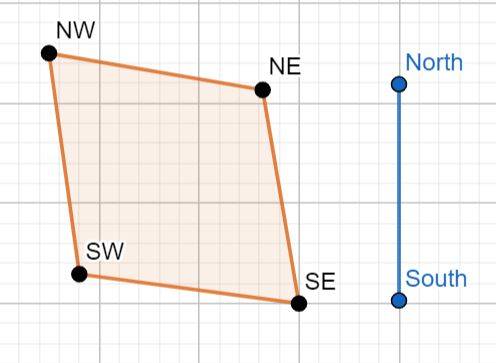

As the shape of the crate would be rhombohedron once launched, and the train's windows are narrowed as a result of length contraction in the direction of motion, Alice reasons that it will be impossible for the crate launch to be timed in such a way, that the crate will snuggly slide through the window.
Diagram of the crate and window* (Ground frame of reference)
*Dimesions not exact and are for illustrative purposes only
Distance between SW and NE will be 500mm as a result of length contraction
Distance between SE and NW as it is at rest (~707.1mm) due to being perpedicular to the direction of motion
Distance between South and North ~433.9mm as a result of length contraction
If the Assassins manage to line up the South Eastern edge of the crate with the Southern edge of the window frame, by timing the launch correctly, the North Western corner will be further North than the Northern edge of the window frame. As a result, the crate will collide with the Northern edge of the window frame.

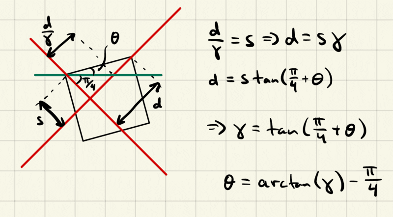

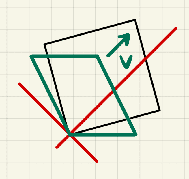

When you do this (assuming knowledgeable assassins) a cubic box of width 2L can fit through a window of width 2L. The corners of the box in the ground frame are:
$$NE = \left(t_g,L \left(\sqrt{1-v^2}-v^2\right)-v \sqrt{1-v^2} t_g,L \sqrt{1-v^2}-v t_g,0\right) $$ $$ NW = \left(t_g,-v \sqrt{1-v^2} t_g-L \left(v^2+\sqrt{1-v^2}\right),L \sqrt{1-v^2}-v t_g,0\right) $$ $$ SE = \left(t_g,L \left(v^2+\sqrt{1-v^2}\right)-v \sqrt{1-v^2} t_g,L \left(-\sqrt{1-v^2}\right)-v t_g,0\right) $$ $$ SW = \left(t_g,L \left(v^2-\sqrt{1-v^2}\right)-v \sqrt{1-v^2} t_g,L \left(-\sqrt{1-v^2}\right)-v t_g,0\right) $$
And the edges of the window are:
$$N = \left(t_g,0,L \sqrt{1-v^2}-v t_g,0\right) $$ $$ S = \left(t_g,0,L \left(-\sqrt{1-v^2}\right)-v t_g,0\right) $$
So the assassins do have a "shot"

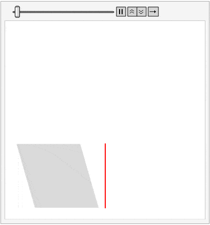

Thanks for the animation.
However, I don't understand how the shape would shift to be in this orientation.
For instance, I can swap the Northbound train out for an Eastbound train going 0.5c with South facing windows of the same dimensions. The velocity and the direction of motion don't need to change for the crate, for Bob to conclude it can enter a window, as based on the Train's frame of reference.
However, based on the orientation of the crate in this animation, it won't enter the window from the ground's frame of reference, the South Eastern edge of the crate will be too far East of the Eastern edge of the window frame.

That is why I didn’t just wave my hands and guess. I actually worked through the math so that I could get the answer without knowing it in advance. Sometimes it is hard to see in advance how this stuff works out.

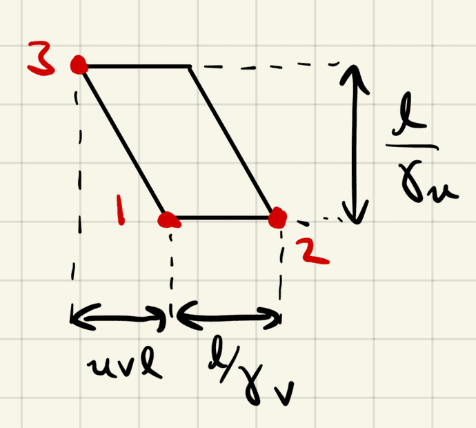

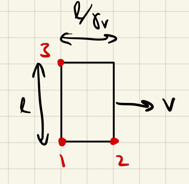

The issue is that non-colinear boosts do not form a group. A pair of non-colinear boosts is not itself a boost. It is a boost and a rotation. So you cannot just swap the Northbound train for an Eastbound train. That would be a different rotation. If the assassins are attacking an Eastbound train then they have a shot, but it is not the same shot as for a Northbound train.
