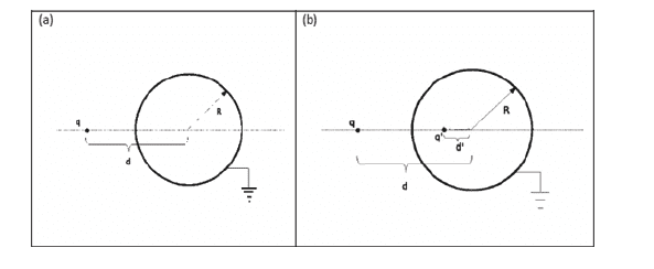

the calculation can be
considerably simplified by using the so called method of images. In this method,
the electric field and potential produced by the induced charge distributed on the
sphere can be represented as an electric field and potential of a single point charge
placed inside the sphere, as shown in figure(b)
the question a is easily solved using gauss law and and the fact that the potential at the surface of a sphere is the same
but the second part how do i go about doing it
i know there are many websites that teach how to derive the method of images but i wanted to try it out myself so i want to know a hint thanks

The potential problem has a unique solution. That means that if you find a solution that satisfies the Laplace equation, then you have THE solution. The method of images exploits this for the part of space outside the sphere: you wiggle a ##q'## in such a way that the boundary condition ##V=0## is satisfied on the surface of the sphere.

ok then this is what i have
v is the potential
v(centre) = 0 hence potential cause by q' at centre is opposite of potential of potential caused by q at centre
\frac{k q}{d} = -\frac{kq'}{d'}\\
\frac{ q d'}{d} = -q'\\
the potential at left intersection of axis and circle is also zero hence at there also potential caused by q' is opposite of potential caused by q
V(surface) = 0\\
\frac{kq}{d-R} = -\frac{kq'}{R-d'}\\
\frac{q}{d-R} = -\frac{q'}{R-d'}\\
solving ,\\
d' = \frac{Rd}{2d-R}\\
q' = \frac{-qR}{2d-R}
is this correct?

No. What is the meaning of your equations?

No, why should it be so?
When you apply the method of images, you replace the sphere by the image charge. You do not have a metallic sphere any more, only two point charges. These two charges should make the potential zero at the points of the original sphere.

The centre is irrelevant. But the potential must be zero at every point of the sphere, at points A and B, for example.
It can be shown that the potential is zero everywhere on the spherical surface, if it is zero at both A and B.
Using d' and q', you can calculate the electric field/potential outside the sphere, but not inside.
ok thanks with the problem how do you show the potential on the surface is zero all the way if a and b is zero is it that the potential on the surface of a conductor is constant
On the surface of an ideal conductor the electric field lines have to be perpendicular to the surfacae: if the parallel component would be non-zero, the charges would simply move along the surface, rearranging themselves until that parallel component is zero. That means the surface of an ideal conductor is an equipotential surface (##\ \Delta V = \int \vec E\cdot\vec {dl}\ ##).
And if the conductor is grounded, that potential has the value zero.
