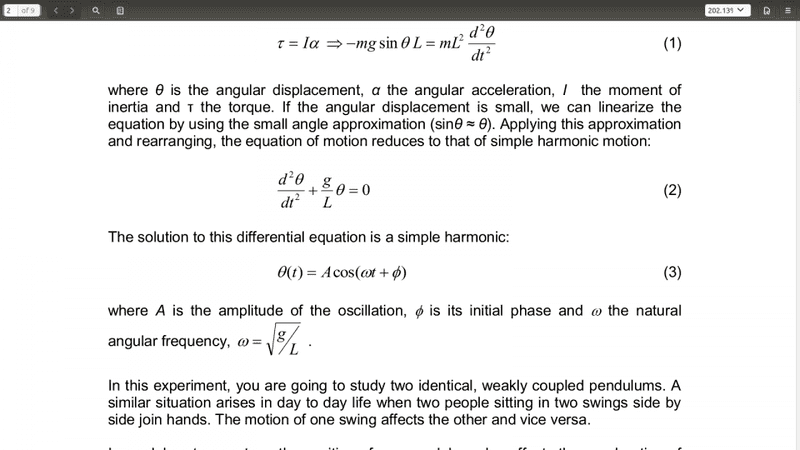

Hi guys I am having a problem deriving this solution for a simply pendulum. Could someone please help me.
My issue is taking the second order and getting into just cos. I have attempted a solution which is shown below.
$$\theta^{''}+\frac{g}{l}\theta=0$$
$$ p^2+\frac{g}{l}\theta=0$$
$$\omega^2=\frac{g}{l}$$
So general solution: $$\theta (t) = Ae^{i\sqrt{\omega t }}+Be^{-i\sqrt{\omega t }}$$[/B]using the fact that: $$e^{(\pm) i \omega t}=cos{\omega t}\pm sin{i\omega t }$$
I get the general equation:
$$\theta (t)= (A+B)cos(\omega t)+ i(A-B)sin(\omega t)$$
I am now confused on what to do next. I was thinking that beacuse I am only looking for real values the i component would be equal to 0. But I do no think this is the case, I am just really can't figure why.

There should be no square root there. The next step should be to convert this equation to a single exponential with a phase shift.

As Dr. Claude has said, you should be looking at ##e^{\pm i \omega t}##, without the square root. Anyway, ##A## and ##B## are just some constants; they can be complex, so you could end up with real ##C_1 = A+B## and ##C_2 = i(A-B)##. Can you see how to write ##C_1 \cos (\omega t) + C_2 \sin (\omega t)## as ##C_3 \cos (\omega t + \phi)## of ##C_4 \sin (\omega t + \lambda)?## (Hint: it is a standard trick, used everywhere.)

A and B are not real; they are complex. But as [itex]e^{i\omega t}[/itex] and [itex]e^{-i\omega t}[/itex] are complex conjugates and we want [itex]\theta[/itex] to be real, we must have [itex]A[/itex] and [itex]B[/itex] as complex conjugates, [itex]A = \frac 12 (C - iD)[/itex], [itex]B = \frac12 (C + iD)[/itex]. Thus
[tex] A + B = C \in \mathbb{R}, \\<br /> i(A - B) = D \in \mathbb{R}.[/tex]
