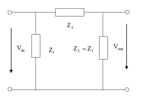

Design a π section symmetrical attenuator to provide a voltage attenuation of 15 dB and a characteristic impedance of 600 Ω.
Zc=600Ω,[itex]\alpha[/itex]=15dB (attenuation)
Z1,Z3=?
[itex]\alpha[/itex][dB]=20log(Vin/Vout)=15
[itex]\alpha[/itex]=5.623
Vin/Vout=(Z1+Z2)/Z1
Zc=√ZocZsc
Zoc=(Z1(Z1+Z3))/(2Z1+Z3)
Zsc=(Z1Z3)/(Z1+Z3)
Zc=Z1√1-2/(2+Z3/Z1)
Z1D=600
Z3/Z1=4.623
D=0.835
Z1=718Ω
Z3=3320Ω
I'd be inclined to show the arrows for Vin and Vout upside down to how you have, though I guess it makes no difference.
Vin/Vout=(Z1+Z2)/Z1 should be Z3 not Z2
Your figures give -15 dB, and 609.6 ohms for Zin
I have made a typing error,it is Z3
