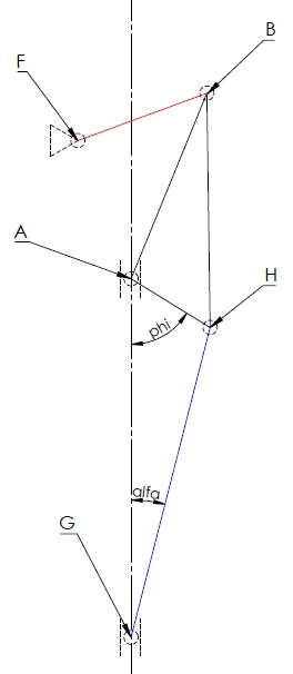

Good morning everyone, I am currently working on a kinematic problem that I am having difficulty solving.
I have been asked to calculate the torque at node F based on the geometry and the force (W) applied at node G in the AG direction.
In particular, node G and node A can translate along the vertical axis and also rotate. Node F cannot translate. There are three rigid bodies, HG, AHB and FB.
I have calculated, correctly I hope, the torque at node A, considering it as a crank-connecting rod case:
T_A = W*AH*sin(alpha+phi)/cos (alpha)
From this, since AHB is a single rigid body, I can say that the rotation of point A is equal to the rotation of point H and, consequently, to the rotation of point B. But how do I link the torque at point A with the torque at point F?
I think I'm missing something, but I don't understand what.

Kinematic diagram of a linkage on a vertical axis: points A, H and B form a rigid triangle, F is joined to B by a red line, and G is joined to H by a blue line. Angles phi and alpha are marked.

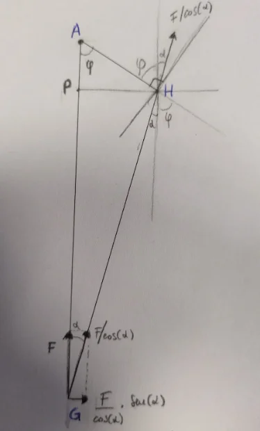

Hand-drawn kinematic diagram of linked rods: point A at top left, point G at bottom, point H with a horizontal line through it, and force F drawn upward at G with components F/cos(alpha) and F tan(alpha) labelled.
I would like to add that the kinematics are placed on a horizontal plane, so the applied force (W) is orthogonal to gravity.
I would like to take this opportunity to add another consideration/question. For the purposes of calculating the torque in F (dependent on angles, levers and force), would a simplification as shown in the attached diagram be acceptable (I consider the force applied in G as applied in B for balance considerations)? In this way, I should be able to write the expression of the delta angle as a function of the alpha and phi angles.
I apologise if I have written nonsense!
Thank you!

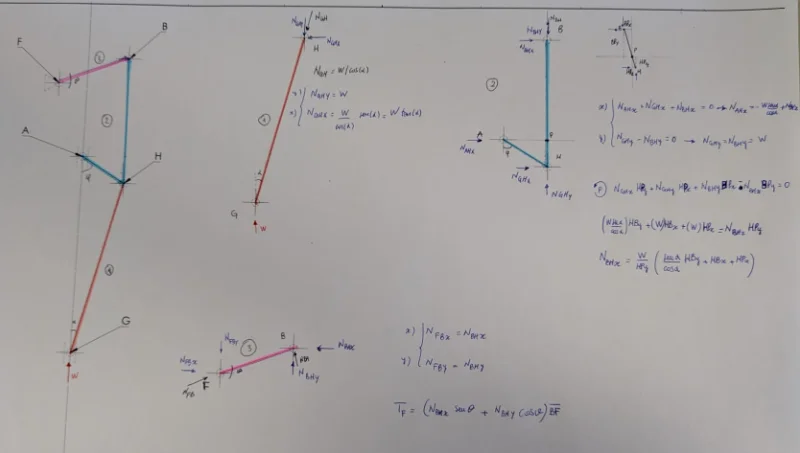

Hello everyone, I've thought about it for a while and have come up with this solution. I would like to discuss it with you to see if there are any fundamental errors in the process or if it could work.
I am attaching my assessments.
Thank you very much!
  • Handwritten free-body diagrams of linked rods labelled 1 to 5 with forces N, W and angles, plus handwritten equilibrium equations and expressions for the tension T_F on the right.
I just need to express the various distances in terms of lengths and angles.
The resolution of the attached photo is too low to make it readable.

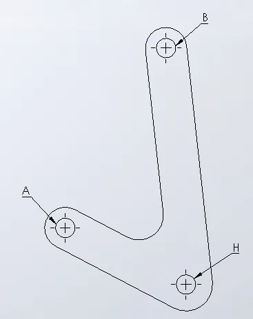

Note that links AB-BH-HA form a solid triangle piece.
Do you have a reason to assume that link BH is parallel to the common axis of the sliders?
I will try to repost my solution with a higher resolution. Yes, the triangle AH, HB and BA is a rigid triangle. You can imagine it as shown in the attached image.
Line drawing of a bent rigid link shaped like a rotated L, with three circular pin joints labelled A (lower left), B (upper right) and H (lower right), connected by straight outlines.
B and H are not on the same vertical line and the rod is not parallel to the axis of the sliders.
