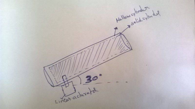

How much force required to pull the actuator pin from the solid cylinder
Weight of the solid cylinder is 15kg
And angle of inclination 30 ,
Coefficient of friction 1.5

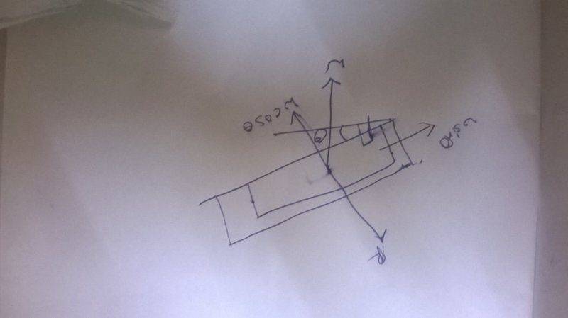

Do you know Newtons second law? Can you draw a free body diagram?
Is friction acting on the pin and/or the cylinder bore?
Yes Friction acting on solid cylinder due to slides on a hallow cylinder ...
Actually I m already calculate the force of solid cylinder acting on a actuator pin
F=wsin30-sliding friction force

If there's no friction on the pin then it doesn't require any force at all to retract it. In fact it'll require an upward force to prevent it retracting under it's own weight.

Shear force doesn't matter. Was there something in post #4 you didn't understand?
Is there friction acting on the pin or not?

No there is no friction acting on an actuator pin the friction acting only on solid cylinder

OK, then post #4 stands.
Obviously real mechanical systems do have friction so the pin will probably require some pull force to disengage.

So less than zero as billy joule said in #4 and #6.
