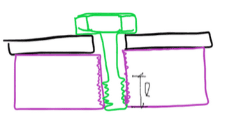

Hello all,
In a recent discussion, I came across this question of influence of free length (or unthreaded length) in bolts in retaining the clamping force between the elements to be joined. Out of the two proposals in the attached pic., which one will keep the two plates clamped for a longer time:
Here are some assumptions:
1. Materials of respective parts are same in both A and B
2. Diameters of the two bolts at comparable locations are also same
3. Torque given to tighten the bolts are also same
4. Length of thread engagement is also same
Pl. let me know your views. Thanks.
The free length of the shank is an elastic energy store in both tension and torque.
1. During installation, the long shank will need to be slightly over-torqued, then backed off to release torque remaining in the shank. (A shank subjected to torque, is proportionally shorter than one without).
2. During operational life, there should be no difference.
3. At the end of life, corrosion between the surfaces will force the plates apart. That will stretch the shank. The longer shank will extend the life before the bolt finally yields.
What do you think and why?
To me it really doesn't make difference. Let me think it out loud:
  • Longer shank (=unthreaded area in the bolt) is less stiff
  • For a given torque this can thus stretch more
  • Shorter shank is stiffer
  • For the same torque this will stretch less
  • But in either case, the preload between the male and female thread sufaces will be the same, thus making no difference from keeping the plates at certain clamping load over time.​
What do you think?

Thanks. What do you think on the clamping load between the two plates when the bolts in two conditions were given same tightening torque?
The installation process needs to be different if they are to offer the same clamping force. That is because more torque can remain in the shank of the longer bolt, which is shortened in proportion to the magnitude of the torque.

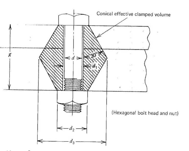

A bolted joint subject to variable loads can cause fatigue failure of the bolt. Bolt fatigue failures are caused by stress variation in the bolt. The bolt alternating stress is the same regardless of the clamp load, as long as the bolt clamp load is sufficient to keep the joint together.
Bolted joints with high variable loads are designed to reduce the alternating stress in the bolts. The relative stiffness of the bolt and joint affect the amount of stress variation in the bolt. A low stiffness bolt in a high stiffness joint has low alternating stress in the bolt, while a stiff bolt in a flexible joint has high alternating stress in the bolt.
The analysis is discussed in Fundamentals of Machine Component Design Second Edition, by Juvinall and Marshek (and other books), from which the following diagram was scanned:
The hatched volume has a column stiffness, and the bolt has a column stiffness. The longer the bolt, the lower the bolt stiffness.

Averagesupernova said:
I've had engines apart with a timing gear held on in the most seemingly stupid way. You guessed it, a bolt that seemed overly long. Torque instructions were X degrees after the slack was taken up. The elasticity in that bolt kept it tight. Main and rod bearing caps rely on something similar as do head bolts.
This is a bit confusing to me. If you tighten by X deg for both the proposals A and B, IMO B will be the better case. B has smaller shank length which means it has higher stiffness. For same angular rotation of the bolt, the one with more stiffness (which is B) will create more preload on the threads and hence should retain them engaged for a longer time. That's what I 'think'...
It won't make more preload. If one bolt can take a higher preload, so does the other. the preload shall be the same in both cases for comparison.
The difference would lie in elongation under load. For the same stress, the strain (elongation divided by length) will be the same. This means that if a part is compressed under an external load - reducing the length of the bolt holding it - the shorter bolt will experience a larger strain, thus having a temporary lower stress and, consequently, preload. That is how things get loose with vibrations.
