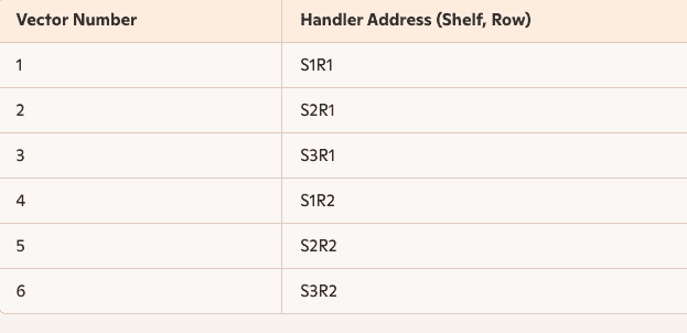

I want to design a hardware circuit for a library system which fetches books by maintaining a catalog of all books & referring the catalog each time the location of book changes. This ressembles to handling interrupts using Interrupt vector table.
Implementing interrupt handling mechanism using interrupt vector table for a daily life (real time) example.
I want to design a hardware which implements a logic of accessing books from a library system.
The library system contains 3 shelves, 3 racks on each shelf, & some books.
The aim of the circuit would be to fetch the desired book from the shelf based on using a catalog table. The catalog table consist of a catalog number & the book address. Each book has a unique catalog no. associated with it.
I have assumed two scenarios.
1st- Initial location of the books is made know to the CPU.
2nd- the book of interest which we want to access is stored to a new shelf.
Now this fetching can be achieved by two approaches:
1. Making the cpu remember the change of the location of a book each time when the location is changed will cost cpu resources & will be inefficient.
2. By maintaining a catalog table which is updated each time a book location is changed, the cpu just have to look at the catalog table & just have to execute a jump operation to directly fetch the desired book.
Approach 2nd is also called an interrupt vector table approach, which is easy, efficient, less complex & low resource consuming.
So I want to design a hardware circuit which makes use of a vector table to fetch the required book from the shelf. How should I proceed?
Those who are genuinely interested can refer the attachment pdf for further insight about the problem.
Thanks!!

There are so many levels for the meaning of "design a hardware", that your problem is nothing to do with a table of jump vectors.
It seems to me, rather than a book library, you are designing something more like a tool carousel stack, for an NC machine.
Why does the word "hardware" appear in your question? What technology are you considering?
I think your "hardware" is a generic computer. It will have a CPU, memory etc. How you chose to use them is a SW architecture question. Sorry, I know I'm not answering your question. It's kind of an odd format for a real engineering problem. It sounds a bit like a homework problem in that way. As a HW guy, I am 100% sure this is a SW problem. So, I'll reiterate...

But on a reread, I think you are using the term "a hardware" to mean an embedded computer system.
I want to design the cpu for this specific purpose only, so yes you are right, an embedded computer system (which should have an Input unit, cpu & output display)

case1:
let vector no be- 001 (shelf 1)
calculation of entry address: Shift Left by 2:
001
00100
(binary) which is 4 (decimal).
address calculation: 0xFFF00000 + 4 = 0xFFF00004
0xFFF00004 address is the entry address which contains the handler address
case 2:
now location of book B1 is updated to new location (eg in shelf 2)
so catalog table is updated, reflecting new vector no. for B1 which is 010
010
01000
(binary) which is 8 (decimal).
0xFFF00000 + 8 = 0xFFF00008
so the address 0xFFF00004 & 0xFFF00008 signifies the beginning of new shelf in the memory.
Difference between both the address is of 4, due to byte addressing.
Ok got it till here ...
Now, my query is how to implement all this calculation part in a logic circuit or to make a "no #$@ &@#% microprocessor" out of it @DaveE :smile:, a complete HW solution.
Now how should I begin?
FPGA.

As I said, my purpose was to improve communications. Not to provide any kind of final design.
We now know that all he wants is to display a message. But the OP also wants "design a CPU for this specific purpose".
So, anyway, later tonight I will reread his posts and see if I can find the shortest path between what he's thinking of and what common HW/SW development tools and components are available.

At the core of the OPs system, there must be a table with two fields per entry, the book name and the shelf location. Such a table is much easier to use and maintain by software on a computer system that by custom hardware circuitry. For one thing, all the book names will be encoded as strings of characters - in the simplest cases, ASCII. Those strings can be manipulated directly by custom HW circuitry, but the primary result would be to make the project orders of magnitude more difficult.
Since that table is going to be maintained (as new books are added or shelf assignments change), it makes little sense to use specialized circuitry to use the table for querying shelf location. When a book query is performed, step one will be to read the book name - likely from keyboard input - which is best a job for software. Then the entry must be found in the table. If there is concern about how quickly this can be done, there are SW techniques (hashing, binary searches) that can make this search faster than your librarian can read the result. Once the table entry is discover, the shelf ID is available. Since all you want to do is display that ID, no specialized HW circuitry will be required - or would even be useful.
So, I think we need to focus on what you (the OP) are looking to accomplish. I very much doubt that this is a homework assignment - I just can't see someone interpreting any homework assignment such that it comes out looking like the OPs postings. So, I am guessing you are assigning this project to yourself because working this kind of HW circuitry is of interest to you (the OP).
If that is the case, please describe what you are looking for, what kind of experience you have, and what kind of resources are available to you - for example, what's you time and money budgets? Also, how interested are you in working with a computer? The reason I ask that is that any circuitry that interfaces to a CPU will require the use of computer applications (for example, minicom or PuTTY) and/or some custom SW development.
