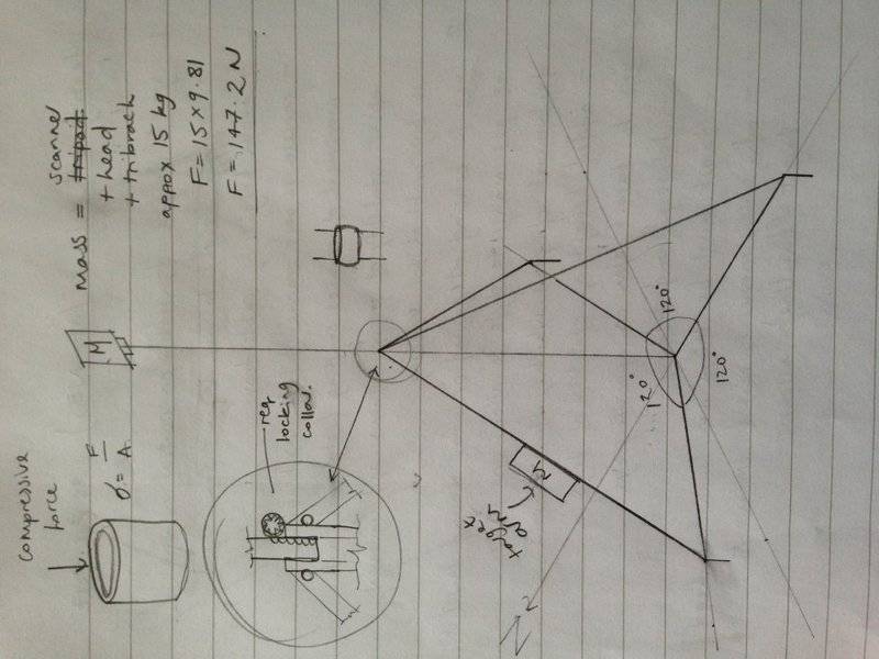

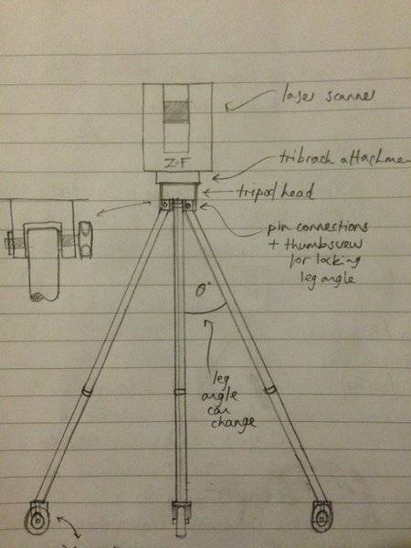

OK guys, thanks for the feedback.
To give you a bit more info, essentially what this is is a method for making a laser scanner mobile, so I'm wanting to design a tripod system that is mobile. The laser scanner attaches to the top of the tripod using a standard Tribrach attachment. The mass itself is a laser scanner, it's essentially a rectangular box that weighs approximately 9kg, but I wanted to design the tripod to support more weight than that.
I want to design something that can make the tripod mobile, so it needs to have casters or wheels but also it must have a method of immobolising so that it can be held in place whilst a scan takes place. My thoughts are either to use a simple braking caster system or a pin that lifts the wheels from the ground temporarily.
Sketch attached - it is by no means perfect, it gives a rough idea of what I'm thinking.
Ah, then my idea won't work. I was going to suggest mounting the mass underneath the apex of the tripod, to add stability and strength. That won't work for a laser scanner.
How do you plan to level the scanner?
The scanner can be levelled on the Tribrach attachment, it allows a 3 point adjustment.
Any advice on how I can calc the bending moments and stresses?

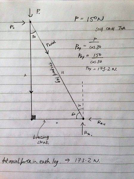

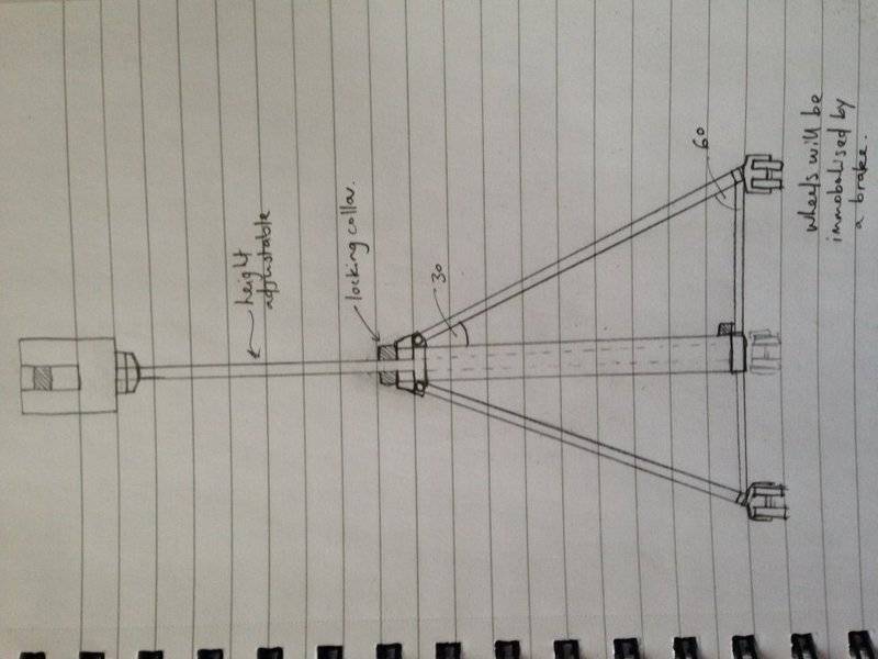

Can anyone help please? @Nidum ? I have changed the design slightly from what I posted originally. The legs are now braced at the bottom. I need some assistance in completing force diagrams/stress analysis... HELP
Please post a drawing of the structure that you now propose using . Preferably a proper technical drawing done using CAD but a good hand sketch will do pro tem .

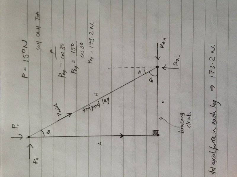

(1) Assume that the column , legs and cross struts are all pin fixed to each other .
(2) The column is not supported at the lower end by contact with floor or by rigid connection to the cross struts .
So how does the weight load from the instrumentation unit distribute between the column and the three legs ?
I think the weight load from the instrument and self weight load of the columns is transmitted through the 'locking mechanism' (a collar which is tightened) when the tripod is extended at height, and from here spreads down the legs and column by means of a head piece which supports the connections for the top of the legs. Is this what you mean or have I misunderstood your question?
Essentially correct . The instrument and column weight loads sum at the connecting collar and are supported by the legs only .
So what does the idealised structure and loads diagram look like for anyone leg and cross strut ?
Do you want some help to draw the diagram ?
Yeah, I'm not certain where to start. Can it be based on the drawing that you referenced in your reply above? That's what I had in mind...
ok. Get back to you asap .
