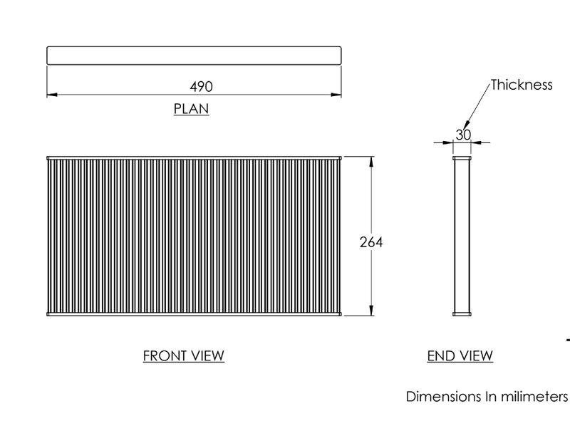

Thanks for the input @Lnewqban! In my case, we're actually designing and manufacturing the heat exchanger ourselves, so we don’t have a datasheet or pre-existing performance curves to rely on.
Before I determine the optimal pump and fan speeds for efficient heat dissipation, I assume I'll need to experimentally verify the performance of our heat exchanger. Could you provide any guidance on how to do this effectively? Specifically, are there recommended methods or key parameters I should be measuring during these tests to establish reliable control inputs for my thermal system?
Any advice or references would be really helpful. Thanks again!
How big of a heat exchanger are you working on? How much heat do you need to pull out of the hot source and at what rate? Is the cold side just ambient air?
Also, which type of heat exchanger are you working with?

Thanks for the input @berkeman! This is an air-cooled heat exchanger setup, where the heat source outputs 5 kW of heat. Throughout the charging process, I need to maintain the heat source temperature below 60°C.
How should I determine the optimal fan and pump speeds for effective cooling in this scenario? Also, if I need to measure the performance of the heat exchanger beforehand, is there a recommended method for doing this?
