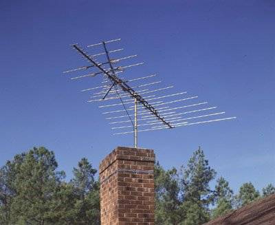

The issue is one of signal size. The signal that you pick up with the antenna will be quite small, and you won't be able to see it on an oscilloscope without a lot of gain first. That's what using a spectrum analyzer does -- it has lots of gain, in addition to showing you what frequencies are present in the received signal.
So you need some type of preamp between your antenna and your oscilloscope. Since 75-100MHz is near the FM radio band (in the US anyway), you might be able to just use a simple TV-type antenna and preamp.
http://www.summitsource.com/images/products/AMG212.jpg
Keep in mind, though, that you will also pick up a lot of other signals with your antenna, and it may be difficult to be sure which signals are from your device. Usually such measurements are done inside a shielded room, to eliminate the ambient RF signals that surround us.
Another option is to use a "sniffer" probe, which is a smaller probe that you hold close to your circuit to pick up the local RF. You still generally need a preamp when using a sniffer probe, though, because of the small pickup signal.
