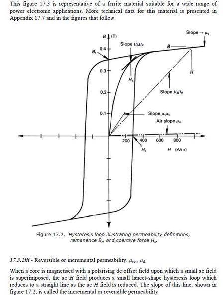

I've been attempting to spec a toroidal inductor--what core size, what material and how many turns? I happen to be looking at some made of the material Kool Mu.
The material if ferrite, so I presume most of the core loss is hysteretic BH loss, as ferrite doesn't conduct well.
Anyway, all I am given is the core loss as a function of frequency and Bmax. They presume that the DC current is zero and the current is entirely AC.
But my design requires the core be capable of a large DC current that varies slowly and sinusoidally from -20A to 20A and a small AC current of about 2 amps peak to peak at a much higher frequency. (The low frequency is 60 Hz, and the high frequency is about 100 Khz.)
It's the high frequency component that contributes directly to the the lion's share to core heating.
Is there a way to infer the core loss when there is a large DC current component when you are given the AC data alone?

A DC offset current gives an offset H0. The hysterysis loop results from the smaller AC current component circulating around B0,H0.
Mu is not constant but varies as a function of H.
The manufacturer supplies parametric curves for power loss vs. Bmax and frequency. Given this information, is it possible to infer power loss at some other operating point B0,H0?

I'm beginning to think that hysteretic loss may only a function of B_peak_to_peak and frequency since excursion of H doesn't seem to be quoted by various manufacturers. Either that, or publishing a lot of power loss curves for various DC offsets is not fashionable.

However, the experimental constaints are absent in both cases: are the excursion of H and B centered about B=0 and H=0 in the quoted parametrically fitted curves?, and does it make substancial difference if they are not?
(Somewhere in my random internet search for an answer I came across an explanation of the mechanism for core heating. It was explained as magnetic domains jumping crystaline boundries. This makes some sense, [ignoring other interesting properties of magnetic domain size restrictions] as it would induce sudden latice distortions that would manifest as heat.
I think that the independence upon the H field makes sense if the mechanism driving domain orinentation is a function of the B field independent of mu.)
I found this which might be of interest:
http://homepages.eee.strath.ac.uk/~bwwilliams/Book/Chapter%2017old.pdf"
