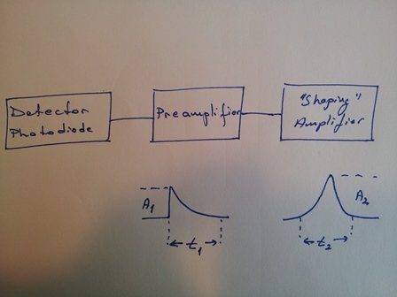

Hello everybody, nowadays I am working on shaping amlifiers and need guidiance about how to design one and do its simulations before pcb design and manufacturing. When googling about shaping amplifiers i found documents mostly about filters (active and passive), which i know works for rejecting some frequencies. So how can i convert a filter to a shaping amplifier? For example designing a CR-(RC)^4 filter which sems a gaussian output shaper.

my purpose is to get a gaussian signal, symmetrical shape is best, at the end of my "shaping amplifier". I found the maxim integrated app note "gamma ray detector" circuit. However it gives a bipolar output. So probably i need to learn first the theory of active filters and types, then do some simulations and at the end manufacture it.

Maybe this picture can be helpful.
t1 ~10 us and A1~10 mV for a sample source.
t2 = 10us (means 100kHz signal/radiation detection --> each rad. particle gives one signal)
A2 = 1V
Block diagram: Detector Photodiode feeds a Preamplifier, which feeds a Shaping Amplifier. Below the first block, a decaying pulse labelled A1 with duration t1; below the shaping amplifier, a Gaussian-like pulse labelled A2 with duration t2.
Gaussian output is for spectrum (identifying different energies of different particles.) Also planning to convert it to a digital signal to count the number of signals. I want to build one to learn the steps of designing a detector amplifier.

If I understand it correctly, you want to convert the impulse with an exponential tail into a Gaussian pulse so you can use a pulse height analyser to differentiate between pulses of different energies.You then want to select pulses of a certain narrow range and count those events only.

exactly :) a different particle with different energy produce a signal with (linearly) different amplitude.
for example: 500 keV particle --> 1V , 250 keV particle --> 0.5 V
(btw not a general rule but mostly detector amplification systems work like this)

You appear to be working in a field that needs similar circuits to those used in XRF analysis. It seems that analogue circuits are now being superseded by digital processors.
http://www-physics.lbl.gov/~spieler/Heidelberg_Notes/
See; All sections, VII is a good introduction to reality and PCB layout requirements.
http://www.niu.edu/~mfortner/PHYS690B/Pulse%20Shaping.pdf
Google “XRF shaping circuit”

You want the CR-RC shaper discussed in Helmuth Spieler's notes that Baluncore linked to.
The preamp can be simple but you need to follow the design procedure in Spieler's notes carefully because it will set your noise performance.
LTSpice is an excellent program for investigating this system. Start with idealized components and go from there.

Forget the CR-(RC)^4. Pls take a look at Ohkawa et.al. 1978 (http://www.sciencedirect.com/science/article/pii/0029554X76901531). This paper describe the design procedure for " Direct synthesis of Gaussian Filter for nuclear pulse amplifiers" and also https://www.researchgate.net/publication/267338240_Low_cost_front-end_readout_electronic_for_instrumentation_used_in_neutron_experiments - similar method with Salen-Key Low-pass fillter topology. Hope this infos will help you.
