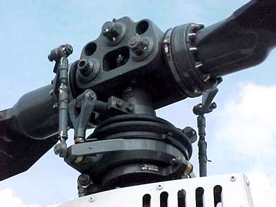

Hi Guys,
I have a project to hand in before xmas. Basically I have to design a
connector for a Wind turbine Blade. ie the Blade root, the one that connects to the hub. for this I have to come up with original ideas, so I cannot use another current of previous blade root connector. I have to come up with a few designs and work from their.
so far I have the light bulb connector.( the one with the threads), but I don't want to use this as it some others are using it already.Here are a few things that I am trying to take into account with each design
Interaction with other parts
Tightness(play)
Cohesion
Slippage
Dry Friction
Shear
Cost
Any inputs is really appreciated, even if you think it is silly! I am trying to
brainstorm. so every little helps
thanks you.
how about a dovetail type connection where the shape of the blade root sort of slots into the hub. that's how steam turbine blades attach to their hub

On second thought i probably won't be able to use it, although it is not directly used in wind turbines, it is used in another type of turbine, which my lecturer might see it as using a connector type from a turbine.

Right, in gas turbines, the turbine blades are connected using a dovetail arrangement that's commonly called a Christmas tree or some other clever variant.
What are some methods that you have thought up?
How about something from a Osprey or helicopter? Both have similar mechanisms since both have to pitch.
