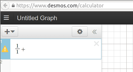

Is it just me or Desmos ruined its formula input? In the past when I typed [m]x[/m], [m]/[/m], [m]1[/m], [m]+[/m], [m]x[/m] I got $\frac{x}{1+x}$. Now I'm getting $\frac{x}{1}+x$. In fact, I can't figure out how to type $\frac{x}{1+x}$ at all. Even if I have $\frac{1}{1x}$ and the cursor is between 1 and $x$ in the denominator, typing $+$ turns it into $\frac{1}{1x}+$. For another example, after I type [m]cos(sin[/m] I get $\cos(\sin\ )$ and the cursor is immediately after "n" (Desmos automatically inserts closing parenthesis). But when I type [m]([/m] again, I get $\cos(\sin\ )(\ )$. The only way for me to enter formulas seems to be to type them in a text editor and then copy-paste them to Desmos.
I am using Firefox 32 in Ubuntu 14.04. I tried these examples in Chrome 37, and they work fine.

What I meant, in fact, was entering formulas on the Desmos site itself, not on MHB. What I described happens when I go to https://www.desmos.com/calculator and start entering a formula in the top-left corner of the page
Could you try this? Are you able to enter $\frac{1}{1+x}$?

Sure.
The result is the same.
1/1+x comes out as $\frac{1}{1+x}$.
I do not get what you show in the screenshot.
OK, it may be just my problem. I do get strange behavior in some text boxes in different applications. (Are they a part of GTK? I am using Unity.) For example, in such diverse applications as Evince and Firefox, when I am entering the name of a bookmark, if I press a capital letter, the input terminates as if I pressed the Enter key. Maybe it's related.
