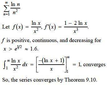

I have another one I am working on. (The solution from the book is attached as a file). If the function that is comparable to the general term of this series is decreasing for values
x > e^1/2, why is one of the limits of integration x =1?
So then, evaluate the integral from 2 to infinity.
So, is it technically improper to evaluate the integral from 1 to infinity?
