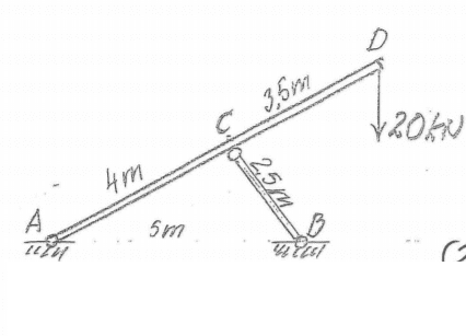

Determine the force in the bar CB. The own weights can be neglected. Look at the first picture for the question.

I solved this with two methods as you can see down below in the picture. Which is the correct way?
I remember I learned in class you could use both ways but why am I getting different results?

For clarification, can you describe the type of connection or linkage at points A, B, and C.
Sorry but my english is not great. I have no idea what you mean with this. Thanks for helping me tho!

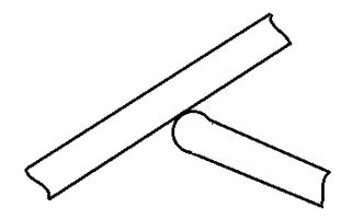

It's not clear to me what's going on at point C. I see two options.
Option 1: The long rod is resting against the rounded, frictionless end of the short rod at C. The other end of the short rod is fixed in place at B so that the short rod can't rotate about B.
Option 2: The rods are free to rotate about points A and B. The two rods are pinned together at C so that they are free to rotate about the pin. (It doesn't look like the two rods are pinned together in the figure.)
Since you are told to neglect the weights of both rods, I think it's probably option 2 that's intended. Your first solution would apply to option 1. Your second solution would apply to option 2.

I'm not sure what you mean by removing the rod CB. You are interested in the direction of the force F that rod CB exerts on rod AD. Suppose rod AD rests against the end of rod CB as shown below. This is option 1 in post #5.
If the surfaces are frictionless at the point of contact, can you deduce the direction of the force F? In the figure, I've exaggerated the fact that the two rods are not perpendicular to each other.

If rod AD rests against rod BC and if there is no friction between the rods, then there is only a normal force between the surfaces at the point of contact. So F is the normal force that rod BC exerts on AD.
