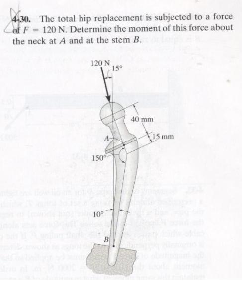

yosheey
The total hip replacement is subjected to a force of F = 120N.
Determine the moment of this force about the neck at A and at the stem B
M = r X F

Um, so I managed to get the moment about a, but I don't know what to do for b
http://imgur.com/Wx939
hello jining! :smile:
yes, your moment about A looks fine (you drew that 5° really large … good idea! :biggrin:)
for the moment about B, do it the same way, extending that 15° line until it gets near B …
but of course you need to know how far down B is, and the question doesn't tell you :confused:
Yea... :| that's where I am stuck haha .. any ideas? Thanks for the help.
oh i see now, i wasn't looking at the diagram properly :redface:
you can find how far that 150° point is to the right, then use the 10° to find how far down it is from there to B :wink:
