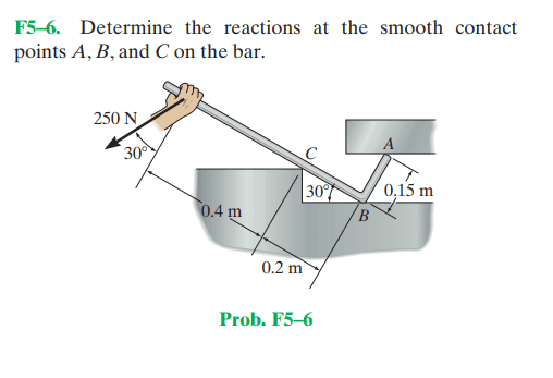

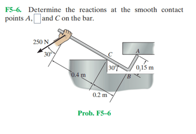

Determine the reactions at the smooth contact points A, B, and C on the bar.
N/A
The figure is shown below:

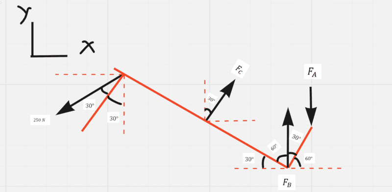

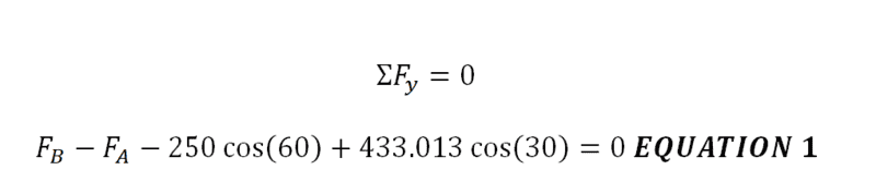

Here is my FBD for the figure with assign +x and +y directions

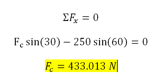

I started off by summing up the forces in the x-direction:
Next is the summing up of the forces in the y-direction:

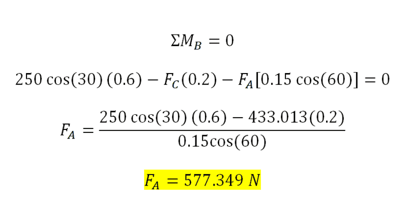

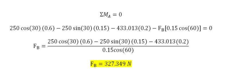

After this, I solved for the moment at point A: assuming that counter-clockwise is +

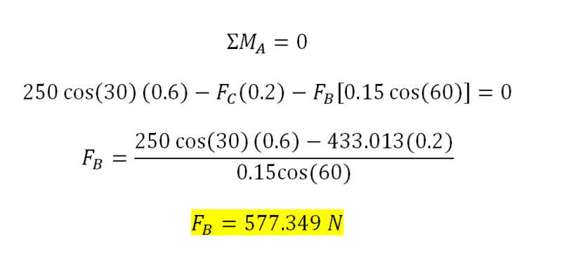

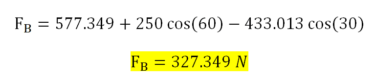

Now from equation 1, if I input the value of F_B, i would get F_A = 827.349 N.

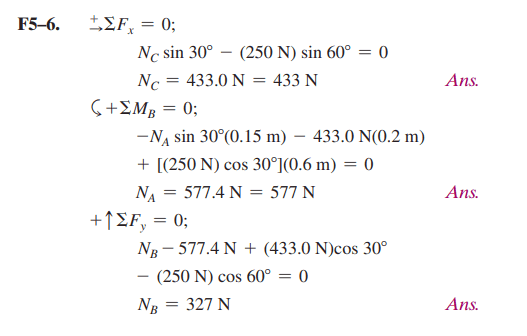

Here is where my question starts. When I tried to search for the problem in the internet to double check the answers that I've got, I only got the Force C right. Mainly because most of them choose B as their moment point. Solution below:
With this, I got two different values for Fa and Fb when choosing the moment point. I tried to find solution in the internet where they choose A as their moment point but I didn't finding anything. I tried to check my solution multiple times but I cannot find my mistake here. Is there something wrong with the values in my solution? Or is it wrong that I decided to choose A as my point of moment?
You left out one of the components of the man's force in your moment balance around point A.

You have represented the reactions correctly, because surface friction should not be considered ("smooth contact points").
For points A and B, the reactions should be perfectly perpendicular to each flat surface.
For point C, the reaction should be perfectly perpendicular to the bar.
Do you have the full correct response to this problem?
It seems to be a complicated problem the way it is shown.
For stable condition, you either need point C or B, but not both.
Nevertheless, point C seems to be necessary for limiting any sliding of the bar horizontally toward the left.
Perhaps, we should only consider C as a simple horizontal support because of that (otherwise, any vertical reaction in C would need to be subtracted from any vertical reaction in B).

To me it seems the reaction at B is (should be) zero.
Thank you very much! I didn't notice that I left out the component force of 250 N that is parallel to the bar. I've now gotten the same answer.

The solution that is at the last page of the e-book I've got (Mechanics - Hibeller 14th edition) also used moment at B. Here is its solution:
But I've already got the correct solution, as Sir Chestermiller stated that I've left out one force.
