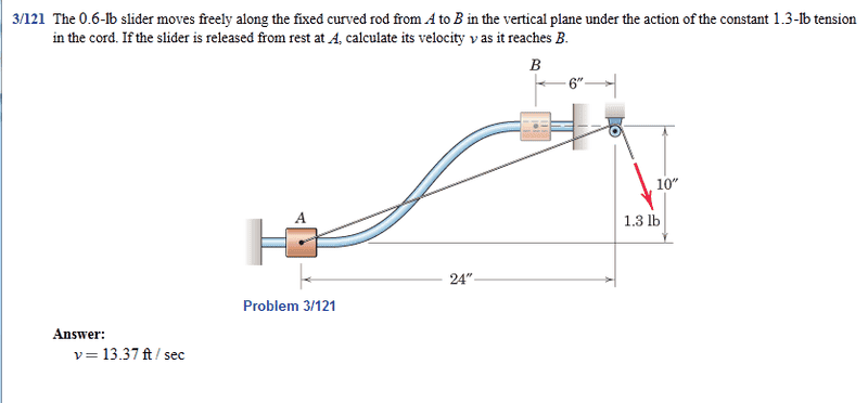

The 0.6 lbf slider moves freely along the fixed curved rod from A to B in the vertical plane under the action of the constant 1.3 lb tension in the cord. If the slider is released from rest at A, calculate its velocity v as it reaches B.
I have attached an image of the question
As far as I can tell this is an energy problem, hence:
T1 + V1 + U1-2 = T2 + V2
T1 and V1 are zero as there is no initial energy, spring forces or gravitational forces at A.
Hence, I get:
(13/12)sin(67.38) = 1/2*(.6/32.3)v2b - 0.6*(10/32.3)
v = 11.28
Not quite the answer I'm looking for and I'm a little unsure where I'm making my mistake.
Any help would be appreciated.

Ignore everything left of the pulley for a moment. If you just watched the string coming over the pulley, how would you figure out the work done by the force?
(Also, I don't understand the division in this term: 0.6*(10/32.3))
First of all apparently the height equals 10 inches not feet.
So the horizontal distance = (24-6)/12 = 1.5 feet and the vertical distance = 5/6 feet
With that said let us solve it using the formula that work equals change in energy.
W = K.E.2 + U2 - (K.E.1 + U1)
As you said K.E.1 + U 1 equals 0 so let's figure out the other values
W = F*S*cosθ, F= 1.3, S= (1.52 + (5/6)2)1/2, θ = 0
So W ≈ 2.23
K.E.2 = 1/2 mv2, m = 0.6/32.3. So K.E. = 3/323 v2
U2 = mgh = 0.6*(5/6)= 0.5
So 2.23 = 3/323 v2 + 0.5
1.73 = 3/323 v2
v2 ≈ 186.26
v ≈ 13.64
