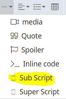

Comment from me: nothing is said about the initial orbit, so I gather you are allowed to assume you start out just hanging up there at 1000 m above the moon and start to fall[edit] Oh, and use the Subscript button
