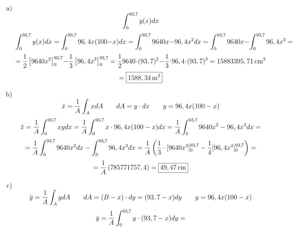

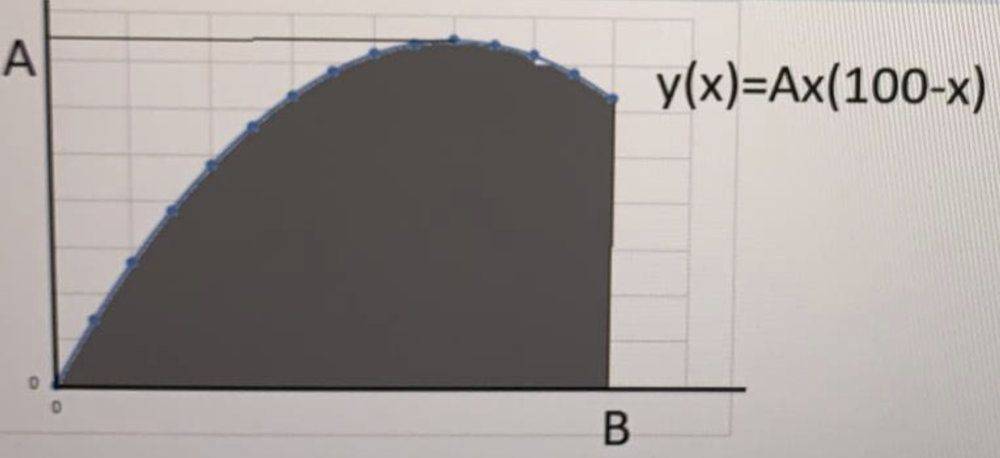

I have the following center of gravity problem:
Having the function Y(x)=96,4*x(100-x) cm, where X is the horizontal axis and Y is the vertical axis, ranged between the interval (0, 93,7) cm. Determine:
a) Area bounded by this function, axis X and the line X=93,7 (in cm2)
b) The bar{x} coordinate of its centroid (in cm)
c) The bar{y} coordinate of its centroid (in cm)
My attempt at resolution:
How can I calculate the last section if I can't clear the x?
Thanks!
You are given y as a function of x, ##y = 96.4x(100 - x)##. Solve this equation for x in terms of y.
IOW, you have y = f(x), Solving for x gives you ##x = f^{-1}(y)##.

Okay perfect thank you!
You can do it with the inverse that can sometimes be unwieldy if the function is complicated. You can also find ##\bar{y}## by integrating wrt ##x##. Consider a vertical strip of width ##\delta x## and height ##f(x)##, then the incremental change in the first moment of area in the ##y## direction is
##\delta S_y = \frac{1}{2} {f(x)}^2 \delta x##
and then you can just integrate up over your limits and divide by the total area.

Yes, I applied this second method in the end, i.e. integrating with respect to ##x## and considering that ##y## was in the middle of the differential.
