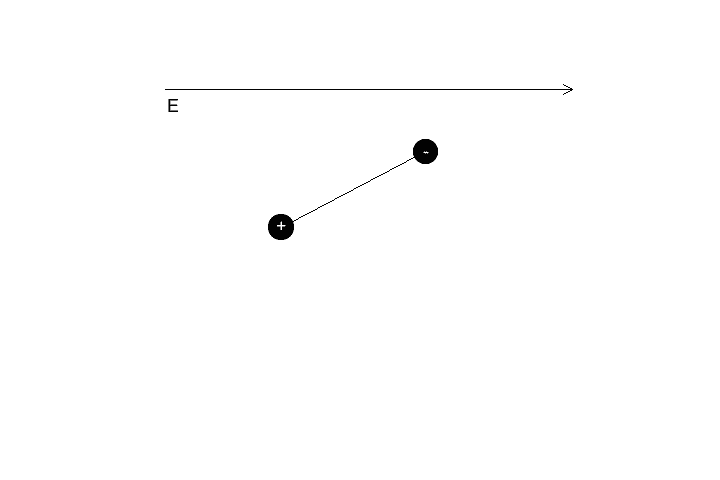

First of all if someone explains me why the dipole
Diagram of an electric dipole: a horizontal arrow labelled E points right to show the electric field, with a dipole made of a + charge at lower left and a - charge at upper right joined by a line.
So in the image above which way should the dipole rotate ? Anti Clock Wise or Clock Wise .

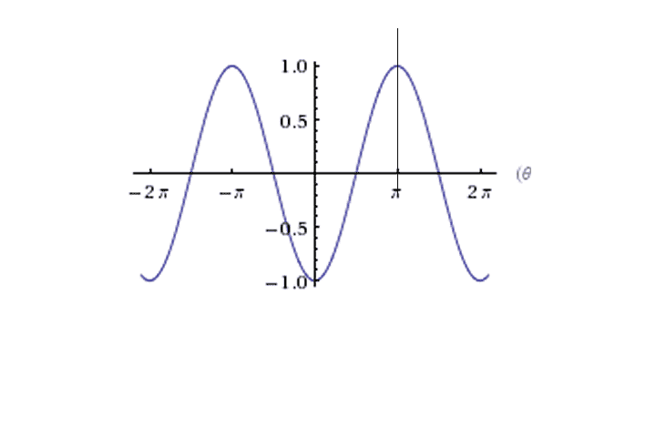

What My intuition says is the Energy of a dipole is
U = -p.E
Which is -pEcosθ
So the Energy Graph would be
Graph of a cosine-shaped curve plotted against theta from -2π to 2π, oscillating between -1.0 and 1.0, with a maximum at π and a minimum at 0.
So there's a Stable Equilibrium at 0 and unstable equilibrium at ∏

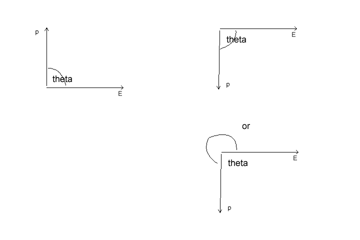

So what I know is that angle is angle made between the E field and the Dipole moment .
What I am not getting is which way is the angle measured ? So if I rotate the dipole moment all the way to bottom will the angle still be same ? Like in the figure ?
Three sketches of a p axis and E axis at right angles, each marking angle theta: upper left with p up and theta counterclockwise from E; upper right with p down and theta drawn from p toward E; lower right labeled or, p down with theta arc going around the other way.
Also still which way the dipole rotate it seems easier for it rotate counter clockwise . But Will it ?
To get the angle, you need to know which way the dipole vector p is directed, and compare that direction with the direction of E.
Alternatively, you could draw force vectors on the (+) and (-) charges, and from that figure out in what direction the net torque is acting.
