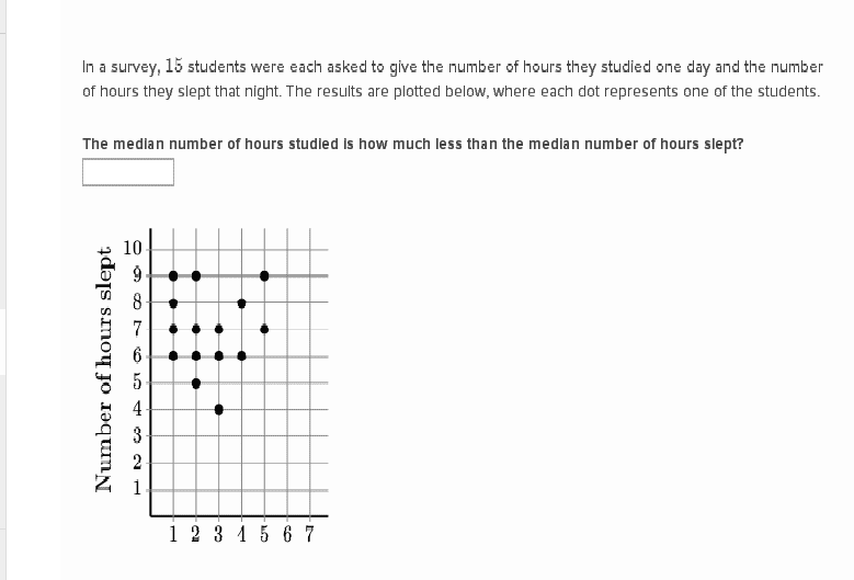

Attempt :
I think I am interpreting the graph wrongly, the median for the Number of hours studied
should be 3 since only There are people who studied from 1~5 hrs,
and for Number of hours slept it should be (7+6)/2 = 6.5 since people only slept for 4~9 hrs .
I am not sure because the answer is wrong. Please guide me
How is median defined?
ehild
Median would be the middle number of a set of numbers that are in order of ascending magnitude.
So, in case of hours to study, you have 1 hour 4 times, 2 hours 4 times, 3 hours 3 times,4 hours twice, 5 hours twice. So the set of hours ordered in ascending magnitude is 1,1,1,1,2,2,2,2,3,3,3,4,4,5,5. What is the number at the middle?
ehild
Well the middle numbers is 2, and for the hours slept it would be 7 oh so the difference is 5.
Thank you . I was being extremely stupid about reading the graph.
