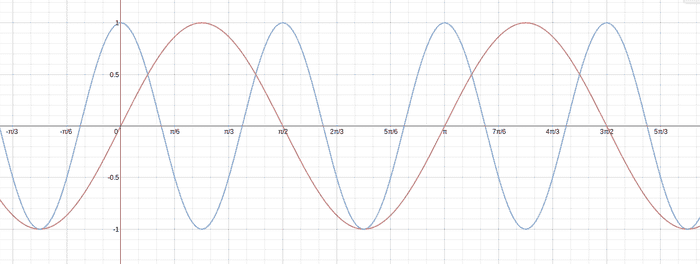

How does that work considering that cos is sin but displaced on the x-axis?
According to this graph, T=pi is wrong:
Never mind.
I'm an idiot. You're right.
Thanks.
No,it isn't.
Look at the respective function values of sin(2x) and cos(4x) at two x's a pi apart.
BOTH functions repeat THEMSELVES here, whether you use -pi/3 and 2pi/3 or "0 and pi" or whatever other couple of x's.
The common period of two functions does NOT mean that they equal each other at those points.
