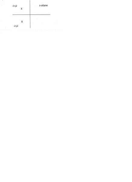

I need to determine the transfer function given the pole-zero chart below. I came up with the following for the transfer function:
H(s) = 1/[(s-(-2+j2)*(s-(-2-j2))] = 1/(s^2+4s+8)
Could someone verify if this is inded the correct transfer function?
Thanks
