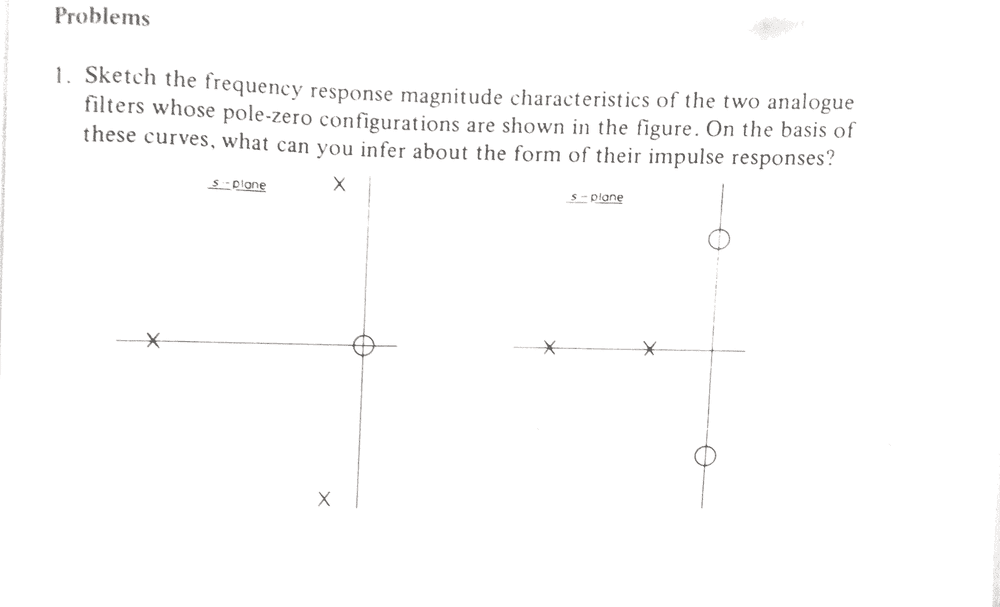

Sketch the frequency magnitude characteristics of the two analogue filters whose pole-zero configurations are shown in the figure. On the basis of these curves, what can you infer about the form of their impulse responses
Transfer functions
Hi,
EDIT: apologies for any ambiguity, but this is for DISCRETE systems, not analogue like the problem states.
I was attempting a problem which is shown below

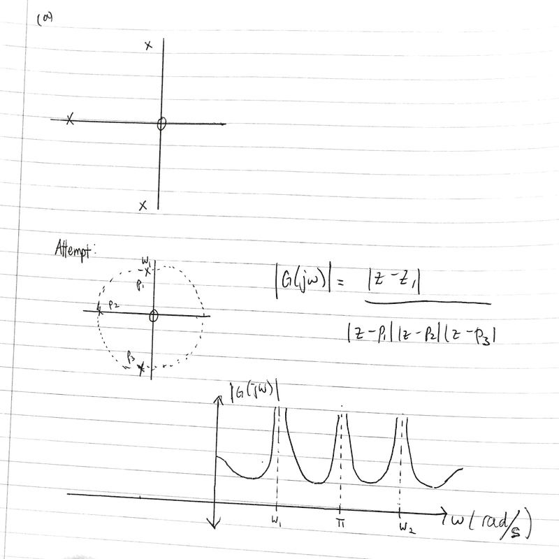

Part (a)
Thus, for the first (left) diagram, I think there should be resonance at the frequencies of the three poles. The effect of the zero is the same for all frequencies.

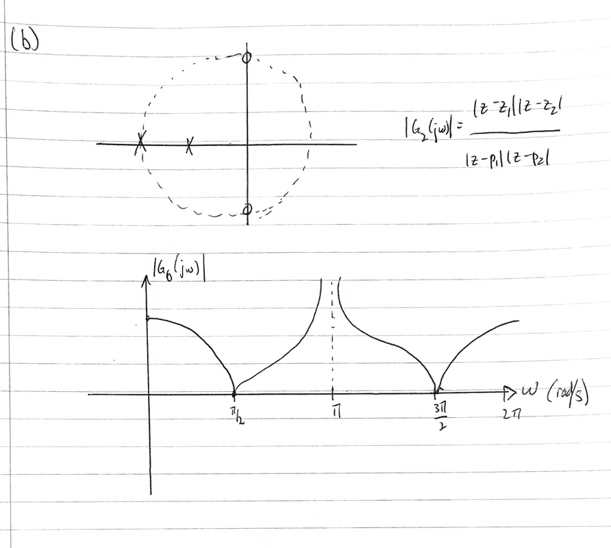

Part (b)
For the second (right hand) diagram, I think there should be resonance at the frequency of the outermost pole (the inner one is within the unit circle) and points of zero gain at the frequencies of the two zeros.

No, not really correct. I think you need to go back and study your course materials a bit more to get this. It's hard to know how to provide guidance without knowing what the material that you've covered in your course is so far. But, I will start with some ideas:
Since you are being asked for the frequency response, then the terms in your magnitude equation like |(z-zi)| can be written as |(jω-zi)|. For frequency response, which is steady state, you will substitute z=jω. This can be visualized as the positive imaginary axis in the complex plane that you drew. At ω=0 you are at the origin. As ω increases (increasing frequency on your plot) you move up on the imaginary axis.
Now let's look at the term |(z-zi)|. This can be visualized as the distance between z and zi. So, for each frequency in your plot, you can measure the magnitude of jω-zi for each pole or zero. You then multiply or divide these according to your magnitude formula.
You will do the same for the phase response, except you aren't multiplying the distance to the poles (or zeros), you are adding up the phase angles. So, for example, the angle from p2 to jω starts at 0 at ω=0 and increases as ω increases, approaching π/2 as ω→∞.
You do not necessarily get a resonance for each pole or zero. Resonance is a description of a rapid change in magnitude (and phase) as ω changes. This doesn't happen if the poles (or zeros) are always far from jω in the plane.
In the real world, roots with a non-zero imaginary part always come in complex conjugate pairs. Which are usually expressed as a quadratic term with real coefficients, like [1 + jω/(Qωo) + (jω/ωo)2]; but this may not be the style that applies to your course methods.

Interesting that the problem statement doesn't have any scale associated with the pole locations. It's not such a big deal in the s-plane since it's the axes that matter. But, in the z-plane inside or outside the unit circle is a really important difference. Are you sure those poles are z-plane poles? The text says "analogue filter" and is labeled "s-plane". Sometimes the system is analog and the poles are described in continuous time, but the filter/controller is discrete time and you have to make the transformation at some point. I'm unclear on when/if discrete time matters here.
Hmm, that is true. We were told that it was a typo, but I will definitely check. I presume the problem was taken from somewhere and quickly repurposed to discrete time (perhaps without fully considering the nuances of the problem originally being set as an analogue)
