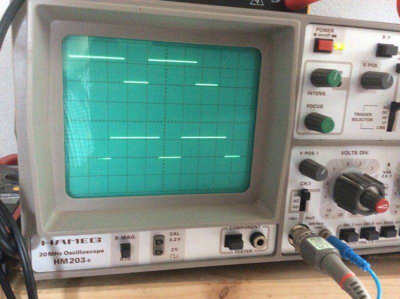

I DO have an oscilloscope; I'm learning how to use it (!).

Update:Replaced IC3 LM358 and IC14 (393) and now the machine powers on, draws about 0.5A at 12.6V, and has 140V on the HV DC rail. Sounds good.
However, no output. I scoped the output MOSFET gates and worked backwards to find the output oscillator, not shown on the schematic. It's on a daughter board:
Its a 16-pin IC, KA3525A:
No Vref, and the Vref pin and outputs are shorted to GND.
I will replace this, but also, the transistor N1, labelled C124 TSN which I think is an NPN, has an open right leg, which I believe is an emitter. I can't find data on this particular package. Can anyone help with a pinout or datasheet? I may just sub in an S9013 and hope for the best.

Scope DC coupled, baseline in the centre, ground lead attached to MOSFET body, probe to gate. 5ms and 50V/div.
34/35:
36/37:
38/39:
40/41:
No load on output. Output was measured with ground on neutral and probe on live. If I put a small load on (40W 230V glue gun) it looks much the same.
IC12 pins 11 and 10 are 0-12V antiphase square waves that grow beautifully in duty cycle upon power-on - the soft start, I suppose.
The bases of transistors 28 and 29 are not being driven evenly. The base of Q28 matches IC12-10, but that of Q29 is in phase but is supressed to 2V, not 12. Similarly, Q31's base only reaches 2V and the low portion is very blurred:
Grounded at main board ground, top trace is on base of Q31, bottom Q30. 10V and 5ms per div.
I'm going to swap out Qs28-31 and the signal diodes, but this won't be for a week or so. I'm taking my old Dad fishing on the Isle of Lewis. In the mean time, thanks yet again for your help.
There be an instrumentation confusion. The IRF640 (Q34 - Q41) has the mounting tab internally connected to the Drain. You are measuring the Gate drive with reference to the Drain, that's why the 150V offset. The measurement reference should be on the Source pin of the MOSFET you are measuring.
The Base drive voltages on Q28 - Q31 appear normal, not worth replacing at this time. Notice that Q29 and Q31 are NPN with the Emitter grounded and the Collector driving the MOSFETs, yielding an inverting, Common Emitter circuit. Q28 and Q30 are PNP with Collector grounded and the Emitter driving the MOSFETS, yielding a non-inverting, Emitter Follower circuit.
The output stage MOSFETs **may** need a minimum load to switch as expected. I would have expected the glue gun to be adequate. However, try using a heaver load to check for a reasonable output waveform. When checking the output waveform, you will have to measure across the load or the inverter "output" terminals.
If the waveform still isn't good, follow the suggestions in my previous post (https://www.physicsforums.com/threads/troubleshooting-an-inverter.917080/page-2#post-5785590)

Back now! I highly recommend the Outer Hebrides if you like fishing. Hundreds of lochs and no-one about - just stop the car, hike across and cast in a fly. No licences/permission/hassle. The wild trout are beautiful there.
Anyway... I put in new 2N2222As at Q29 and 31, as the ones in there were different - perhaps someone was here before me. Also replaced D29 and 31 4148s. Output voltage is only 40Vac regardless of load but looks even:
I assumed the body of a MOSFET would be connected to source, by analogy with metal casings and earth/ground, etc. I was obviously wrong. Here I scoped Q38 gate (top trace) and Q40 gate (bottom trace) with reference to circuit ground:
Q38 gate (top) goes from 0V to about 60V (note messy trace) while Q40 has a much neater 0-12V wave, in antiphase.

Ah-Ha! For Q29, Q31 I notice '2N2222' is penciled in. Something wrong there. The gates of Q34, 35, 38, 39 should approach "+V1" supply (200V) during normal operation. The 2N2222 is rated for 75V maximum. They are breaking down and clamping the Gate voltage, which means that's as high as the Source voltage of Q34,35,38,39 will go. (The Source won't go higher than the Gate because there wouldn't be any Gate voltage left to turn them on.)
Looks like your next job is to find some 300V NPN transistors.:oops:
An earlier scope photo showed Q38,39 having 150V drive (referenced from Gnd.) and Q34,35 having 40V drive. I would hazard that Q31 was a 2N2222 and Q29 had the correct part installed.
