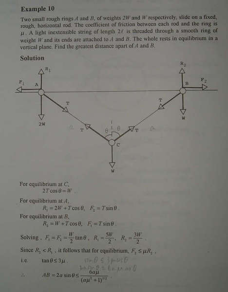

I don't understand the followings:
For equilibrium at A, the equation should be F1 = T sin [tex]\theta[/tex]. Am I right?
While for the one at B, the equation should be F2 = T sin [tex]\theta[/tex]. Am I right?
In addition, how can I get cos [tex]\theta[/tex] = (au2 + 1)-0.5 at the last answer?
Thank you very much!

I tried some methods and found the followings finally:
tan [tex]\theta[/tex] = 3u = 3u / 1
Put the above result to a right-angled triangle with adjacent side = 1 and opposite side = 3u,
we can get cos [tex]\theta[/tex] = (9u2 + 1)-0.5.
I guessed that the "a" is actually a "9" which is a typo instead. Am I right?

You seem to be quite right.
