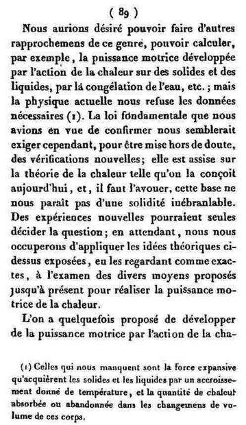

In his book published in 1830, Sadi Carnot expresses doubts as to the universality of his reasoning on gases.
It's on page 89. Is it valid for liquids, solids? And he quotes in the text the freezing of water (increase in volume).

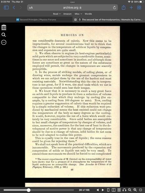

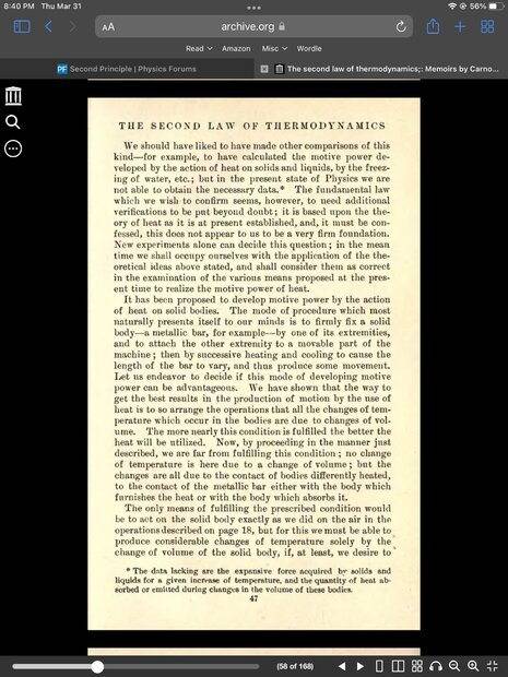

I think this is the page
from “The second law of thermodynamics; memoirs by Carnot, Clausius, and Thomson” translated by Magie (1899)

This was in the introduction of translation

His footnote on page 89 of his book is clear on this. (Original book in French)
Of which I copy the translation provided above by Caz:
... The data lackies (missing) are the expansion force acquired by solids and liquids for a given increase of temperature, and the quantity of heat absorbed or emitted during change in volume of these bodies...
In his book, Carnot also mentions the freezing of water, on which the data of his time do not allow him to conclude.

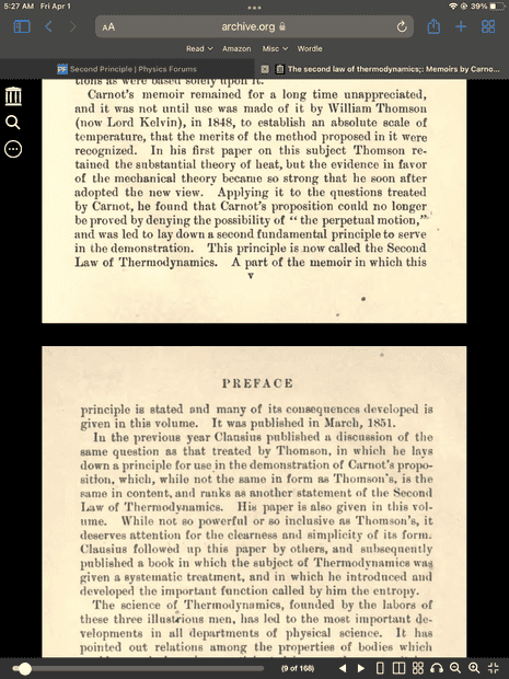

I believe that the Truesdell is quoting Rankine (1851) on page 219.
I read the word lackies as lacking. I apologize for the quality of the copy.
