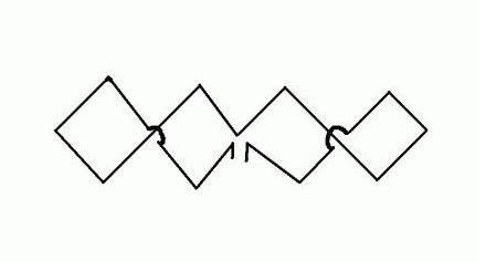

Is it possible to have an antenna of such shape?
The left is the top view the right is the side view.
Why is such design?
What is the scale ?
What is the wavelength ?
What do the colours represent ?

Baluncore said:
What is the scale ?
Are you considering photon emission from a molecule ?
about 2 cm
microwave region
I simply arbitrarily pick a picture from google therefore it has colour

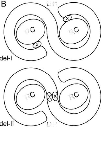

Here is a black and white picture attached.
Is there a loop antenna of such shape? Is there any benefit of such shape?
I have ever seen antnna of square shape as attached. But I do not know what will the effect if
I change the square into a circle?
Are you saying that you think that complex biomolecules are acting as antennas?

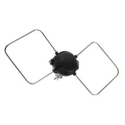

I have ever seen antnna of square shape as attached. But I do not know what will the effect if I change the square into a circle?
The top two pictures are typical square loop antenna arrays. You can make them out of circles if you want, but they will have slightly different radiation characteristics.
I have no idea what the bottom scrolls are or why you might consider using them as antennas. Are they made out of metal or jello? Anything will radiate if you can find a way to drive it. You seem to have no experience with antennas, nor any idea as to how or why they might work. I get the feeling that you are deliberately wasting our time.
When you post pictures on PF you should give a reference or the web link to the original. That way we can work out what their relevance might be. Without a web link to the original they are not only usless but may be plagiarism and lead to a breach of copyright.
I had experience using the square loop antenna for my home DVBT. Each side of the square is 12.6cm.
I remember the gue told me that antenna said the turn of each side will cause some phase change.
Will those square loop antenna will function better than simple loop antenna?
