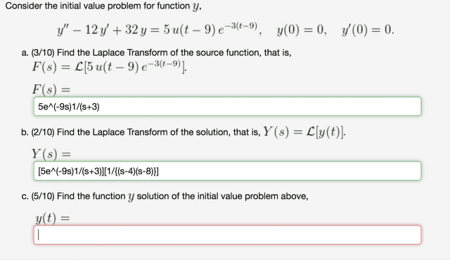

this is my attempt, I figured this would be easier than typing.
any how, I find partial fraction method is so time consuming and very algebraically complicated, is there a trick or another method I could use to make this easier?
thanks

Convert ##Y_1(s) = \frac{1}{(s+3)(s-4)(s-8)}## to partial fractions, then multiply by ##5 e^{-9s}## later; better still, find the inverse of ##Y_1(s)## as ##y_1(t)##; the solution is then ##5 u(t-9)y_1(t-9)##.
The partial fractions can be found easily (but still with some algebra) by applying successively the identities
$$\frac{1}{(s-a)(s-b)} = \frac{1}{a-b} \left[ \frac{1}{s-a} - \frac{1}{s-b} \right] \: \text{if} \; a \neq b$$
