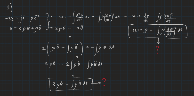

1) From the radial and angular acceleration, a system of 2 diff eqs. Integrating by parts the angular one.
Handwritten derivation in polar coordinates: from -32 = p'' - p θ'^2 and 0 = 2p'θ' + pθ'', integrating gives 2pθ' = ∫ p θ'' dt, with question marks beside the steps.

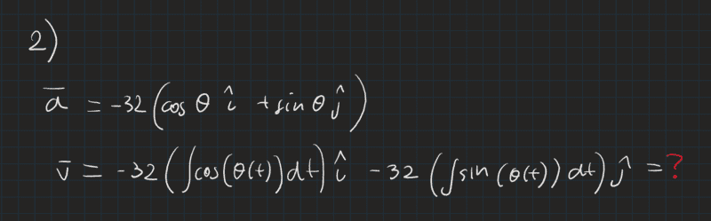

2) Then, by Cartesian subsitution.
Handwritten working on a dark background: '2)' followed by acceleration a = -32(cos θ i + sin θ j), and velocity v = -32(∫cos(θ(t)) dt i - 32(∫sin(θ(t)) dt) j = ?, with the question mark in red.

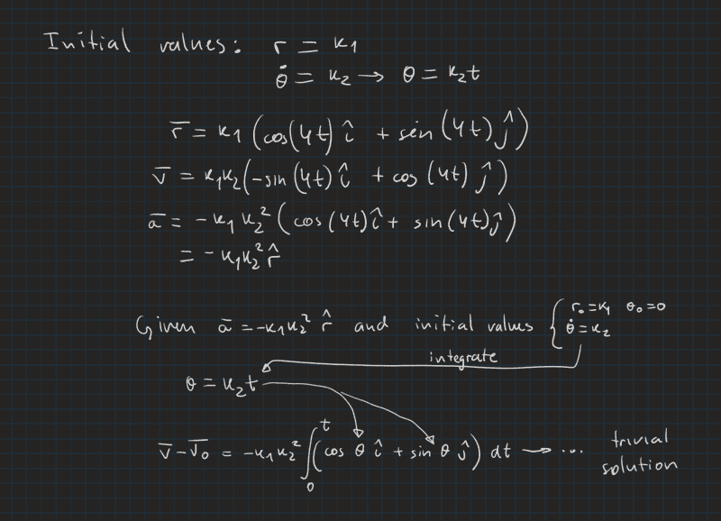

Handwritten derivation of constant-acceleration kinematics in Cartesian components: x'' = a_x gives x' = v_x0 + a_x t and x = x_0 + v_x0 t + (1/2)a_x t^2; y'' = a_y gives y' = v_y0 + a_y t and y = y_0 + v_y0 t + (1/2)a_y t^2.
If this is what you're referring to, then yes I can see I need the initial conditions.Ok, so I did the position to acceleration for circular motion in Cartesian. Then I tried doing the reverse problem, expressed in Cartesian. I think I get it now, I neglected the initial conditions thinking I could solve the problem without them but it is impossible.
Handwritten derivation: initial values r = k1, theta-dot = k2 giving theta = k2 t; r-vector = k1(cos(k2 t) i + sin(k2 t) j), v = k1k2(-sin(k2 t) i + cos(k2 t) j), a = -k1k2^2 r-hat; then integrating v - v0 = -k1k2^2 integral of (cos theta i + sin theta j) dt.
However adding these conditions in particular, that I started out with, makes the problem trivial.

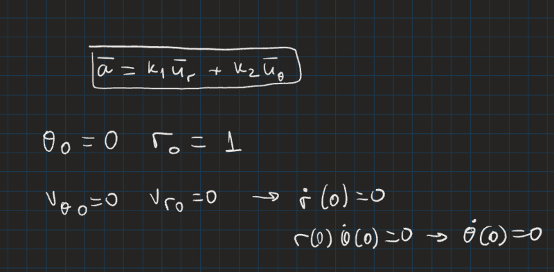

So I decided to propose a new problem.
Handwritten notes on a dark grid background: boxed vector equation a = k1 u_r + k2 u_θ, initial conditions θ0 = 0 and r0 = 1, velocity conditions v_θ0 = 0 and v_r0 = 0 implying ṙ(0) = 0, and r(0) θ̇(0) = 0 implying θ̇(0) = 0.
This is the expression of a general acceleration with constant components in polar coordinates. The initial conditions define the position of the particle at time 0 and its velocity components in polar coordinates. I believe these conditions specify a unique trajectory and should be enough to give a solution, a vector of the position, in polar coords. Looking at it, it is probably a spiral, but prior knowledge of the shape shouldn't be used in the solution as the intent is to be able to solve more complex expressions where you don't know the shape of the trajectory.
I attempted the following solution, but it led me nowhere.

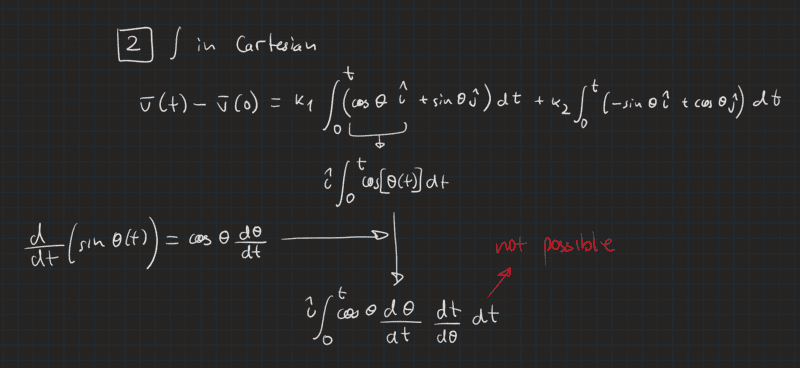

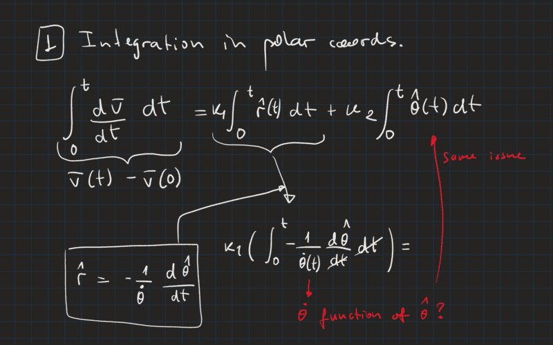

Okay, I tried integrating in polar coordinates and in Cartesian, but nothing seems to work.
Handwritten derivation on dark background: '1 Integration in polar coords.' Integral from 0 to t of dv/dt dt equals k1 times integral of r-hat(t) dt plus k2 times integral of theta-hat(t) dt. Red annotations: 'Same issue' and 'theta-dot function of theta-hat?'
Handwritten derivation on dark background: velocity difference v(t) - v(0) equals k1 times integral from 0 to t of (cos θ i + sin θ j) dt plus k2 times integral of (-sin θ i + cos θ j) dt; below, i times integral of cos[θ(t)] dt, then d/dt(sin θ(t)) = cos θ dθ/dt substituted with dt/dθ factors, marked 'not possible' in red.
