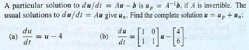

The problem is here, I'm trying to solve (b):
imgur link: http://i.imgur.com/ifVm57o.jpg
and the text solution is here:
imgur link: http://i.imgur.com/qxPuMpu.pngI understand why there is a term in there with [itex]cte^t[/itex], it's because the A matrix has double roots for the eigenvalues. What I don't understand is where the (apparent) second eigenvector, [itex] \begin{bmatrix}1\\ t\end{bmatrix}[/itex] is coming from?
I gave my answer as [itex]\vec{u} = \begin{bmatrix}4\\ 2\end{bmatrix} + c_1e^t\begin{bmatrix}0\\ 1\end{bmatrix}+c_2te^t\begin{bmatrix}0\\ 1\end{bmatrix}[/itex].
This answer works, but so does the text answer, and it is more complete. But where did that second distinct eigenvector come from?

You have a double eigenvalue ##\lambda = 1## with geometric multiplicity one, giving you one eigenvector ##v_1 = (0,1)##, and algebraic multiplicity two. So, in order to span the generalised eigenspace corresponding to ##\lambda## (which is just ##\mathbb{R}^2##) you need a generalised eigenvector ##v_2##, which you can obtain by solving
Av_2 = \lambda v_2 + v_1
(The sequence ##\{v_1,v_2\}## is called a Jordan chain corresponding to ##\lambda## and ##v_1##.) Then the solution to the homogeneous system is
u_n(t) = c_1 e^{\lambda t}v_1 + c_2 t e^{\lambda t}v_2
You can see that your own solution is not the most general one, because at time ##t = 0## you cannot satisfy an arbitrary initial condition. (In fact, as you can see you can only satisfy initial conditions ##u_0## for which ##u_0 - (4,2)## is in the span of ##(0,1)##.) This is because ##v_1## by itself does not span the generalised eigenspace.

A different approach from the one Krylov took...
Since it is straightforward to get a particular solution to the nonhomogeneous problem, let's look only at the homogeneous system:
##\vec{u}' = A\vec{u}##
This system has a solution ##\vec{u} = e^{At}C##, where C is a column matrix of coefficients that depend on initial conditions.
To calculate ##e^{At}##, we'll need to calculate the various powers of A.
##A = \begin{bmatrix} 1 & 0 \\ 1 & 1 \end{bmatrix}##
##A^2 = \begin{bmatrix} 1 & 0 \\ 2 & 1 \end{bmatrix}##
##A^3 = \begin{bmatrix} 1 & 0 \\ 3 & 1 \end{bmatrix}##
In general, ##A^n = \begin{bmatrix} 1 & 0 \\ n & 1 \end{bmatrix}##
If necessary, this last statement is easy to prove.
##e^{At} = I + At + \frac{A^2t^2}{2!} + \dots + \frac{A^nt^n}{n!} + \dots##
##= \begin{bmatrix} 1 & 0 \\ 0 & 1 \end{bmatrix} + t\begin{bmatrix} 1 & 0 \\ 1 & 1 \end{bmatrix} + \frac{t^2}{2!}\begin{bmatrix} 1 & 0 \\ 2 & 1 \end{bmatrix} + \dots + \frac{t^n}{n!}\begin{bmatrix} 1 & 0 \\ n & 1 \end{bmatrix} + \dots##
##= \begin{bmatrix} 1 + t + \frac{t^2}{2!} + \dots + \frac{t^n}{n!} + \dots & 0 \\ 0 + t + \frac{2t^2}{2!} + \dots + \frac{nt^n}{n!} + \dots & 1 + t + \frac{t^2}{2!} + \dots + \frac{t^n}{n!} + \dots \end{bmatrix}##
##= \begin{bmatrix} e^t & 0 \\ te^t & e^t \end{bmatrix}##
##= e^t\begin{bmatrix} 1 & 0 \\ t & 1 \end{bmatrix}##
In the matrix a couple of lines up, the expression in the lower left corner is just tet.
So the solution to the homogeneous problem, ##u_h(t)##, is ##u_h(t) = e^t\begin{bmatrix} 1 & 0 \\ t & 1 \end{bmatrix}C##,
or, ##u_h(t) = c_1e^t\begin{bmatrix} 1 \\ t \end{bmatrix} + c_2e^t\begin{bmatrix} 0 \\ 1 \end{bmatrix}##
In this last form, the two linearly independent eigenvectors are shown.

Mark44 made me realize that I made a mistake in this line yesterday, my apologies. The method is fine, though. From the Jordan chain you build the correct solution to the homogeneous equation as
u_n(t) = c_1e^{\lambda t}v_1 + c_2e^{\lambda t}(v_2 + t v_1)
I'm sorry for any confusion that I may have caused.
