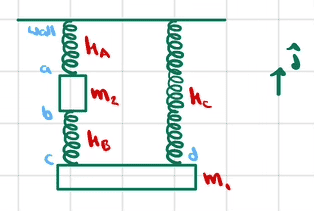

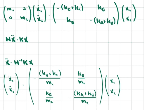

Consider the system of differential equations
$$\begin{bmatrix} \ddot{x}_1 \\ \ddot{x}_2 \end{bmatrix}=\begin{bmatrix} -\frac{(k_B+k_C)}{m_1} & \frac{k_B}{m_1} \\ \frac{k_B}{m_2} & -\frac{(k_A+k_B)}{m_2} \end{bmatrix}\tag{1}$$
$$\vec{\ddot{x}}=MK^{-1}\vec{x}\tag{2}$$
These are the equations of motion for the coupled oscillators in the following picture
I have a question about solving this system.
I (naively, I think) initially did the following
Trial solution: ##\vec{x}=e^{\lambda t}\vec{a}##.
Sub this into the system (2)
$$\lambda^2 e^{\lambda t}\vec{a}=M^{-1}Ke^{\lambda t}\vec{a}\tag{3}$$
$$(M^{-1}K-\lambda^2I)\vec{a}=0\tag{4}$$

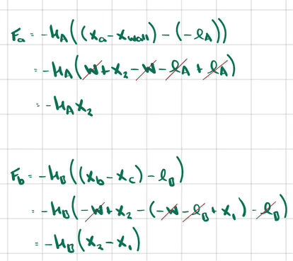

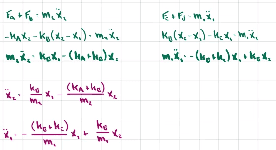

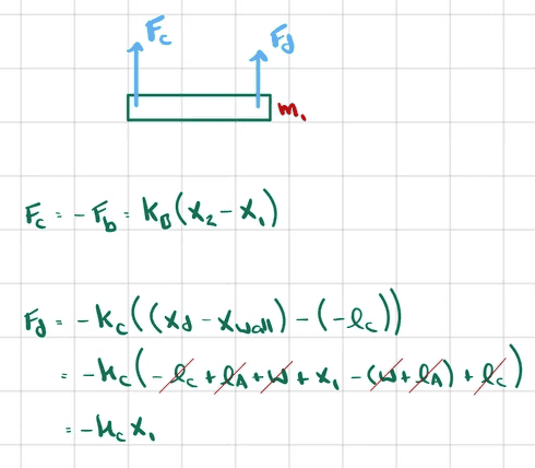

I applied Newton's 2nd law to each of the masses. Since we are not considering gravity, this involves writing out the spring forces on each mass.
I believe I did this in a perhaps unnecessarily lengthy way, but at this stage it makes me more comfortable to do it this way.
Instead of writing it all out in latex, I'm going to screenshot my handwritten calculations.
Recall the setup
First I write the positions of each of the points ##a, b, c, d##, and the wall. I am only considering the vertical direction.
##w## in these equations represents the width of mass 2. I know that this is unnecessary.
Given these positions, I compute the spring forces.
For example, ##F_A=-k_A((x_A-x_{wall})-(x_A-x_{wall})_{eq})## where ##(x_A-x_{wall})_{eq}=-l_A##. The magnitude of the latter is the equilibrium length of spring ##A##.
Now that I have the forces, I can use Newton's 2nd law
The OP is based on this last matrix equation.

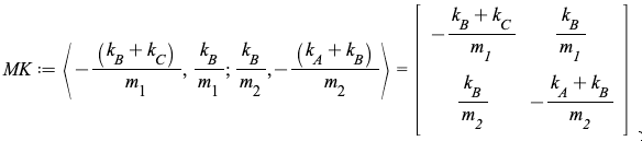

I would like to show the numerical calculations.
Here is the matrix ##M^{-1}K##
\left[\begin{array}{cc}
-\frac{k_{B}+k_{C}}{m_{1}} & \frac{k_{B}}{m_{1}}
\frac{k_{B}}{m_{2}} & -\frac{k_{A}+k_{B}}{m_{2}}
\end{array}\right]

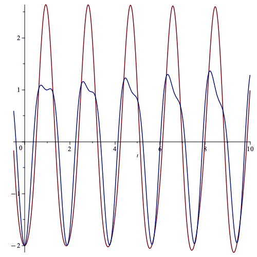

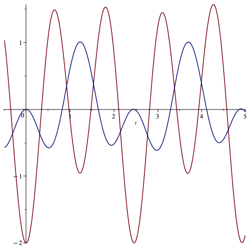

2) Suppose ##m_1## starts at position ##-2## with zero velocity. Then we get
$$\mathit{constants} = \left\{c_{\mathit{1}} = - 0.5049294682,c_{\mathit{2}} = - 0.0,d_{\mathit{1}} = 0.5049294682,d_{\mathit{2}} = 0.0\right\}$$
and the solution ##y## is
\mathit{solution} = \left[\begin{array}{c}
- 0.5228416527 \cos \! \left( 2.524406240 t \right)- 1.477158347 \cos \! \left( 5.111494218 t \right)
- 0.5049294682 \cos \! \left( 2.524406240 t \right)+
0.5049294682 \cos \! \left( 5.111494218 t \right)
\end{array}\right]
and if we plot this solution (again, the first row represents displacement of mass 1 and the second row the displacement of mass 2) then we get

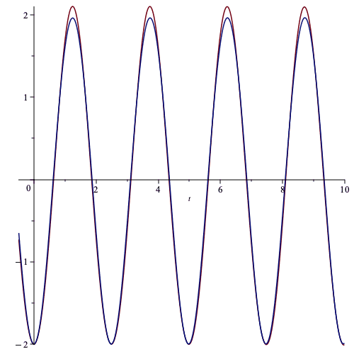

Here is another scenario: both ##m_1## and ##m_2## start at position ##-2## with zero velocity.
$$\mathit{constants} = \left\{c_{\mathit{1}} = - 1.982087815,c_{\mathit{2}} = - 0.0,d_{\mathit{1}} = - 0.01791218455,d_{\mathit{2}} = - 0.0\right\}$$
- 2.052401641 \cos \! \left( 2.524406240 t \right)+
0.05240164140 \cos \! \left( 5.111494218 t \right)
- 1.982087815 \cos \! \left( 2.524406240 t \right)-
0.01791218455 \cos \! \left( 5.111494218 t \right)
\end{array}\right]$$
The red curve represents mass 1.
Not sure, intuitively, why mass 1 has a larger amplitude.

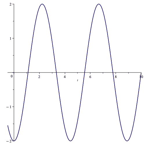

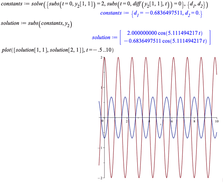

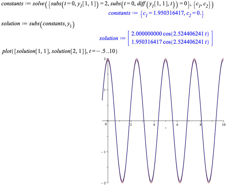

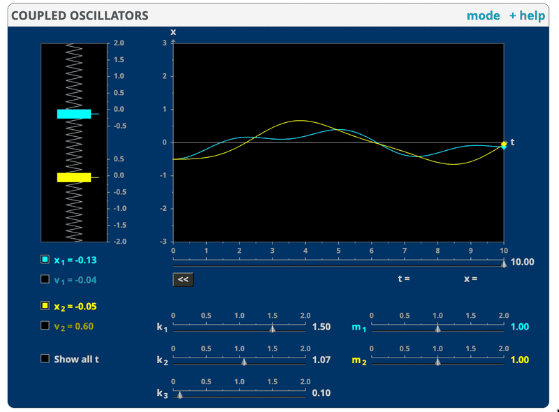

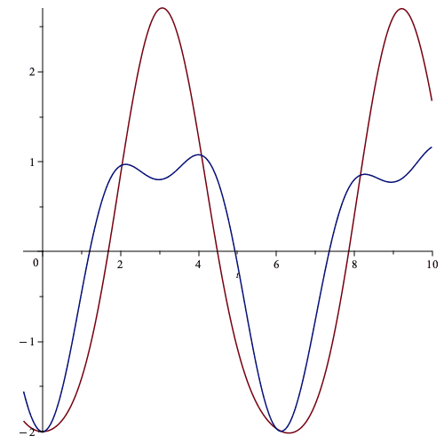

If we make the masses the same at ##4## then we get
This looks weird, but if I try to simulate something similar using MIT's coupled oscillators applet I do get something somewhat similar
Note that the setup is not exactly the same in the MIT applet, but it is similar.
With my calculations and similar parameters to the above I get
Finally, let's check what happens when the masses are the same and the spring constants are all the same.
This
assumes that the bar stays parallel to itself at all times. The setup as you described it is not symmetric about the vertical that passes through the midpoint of the horizontal bar. You have ##m_2## on the left and nothing on the right. Also the springs have all different spring constants.
This means that the instantaneous forces at ##c## and ##d## will be in general different generating a net torque about the middle of the rod. As a result, there will be a frequency of torsional oscillations of the bar to consider that will be coupled to its linear modes of oscillations of ##m_1## and ##m_2##.
To see what's involved, you may wish to try solving a simpler problem. Get rid of ##m_2## and attach each end of the bar (moment of inertia ##I=\frac{1}{12}ML^2## about its CM) to springs of the same equilibrium length but unequal constants ##k_A## and ##k_B##. Displace each end by different amounts from the equilibrium position and release from rest. The problem that you posted is more difficult than this because of ##m_2.##
@kuruman
That is true. Please see the original problem here. It is the last problem in the problem set. I wonder what they have in mind regarding the issue of torque.
There is the assumption that "the unstretched lengths of spring A and B equal the unstretched length C", but this doesn't seem to solve the issue of torque on mass 1.
There is also the assumption that "the masses are constrained to move only in the vertical direction". If mass 1 is somehow impeded from rotating and can only move up or down then I think maybe we can say the calculations I did are correct?
I actually just realized that they are including gravity in the problem. I think this only changes the equilibrium positions. I will add gravity.
It looks like the author of the problem did not consider the possibility of torque. Under the assumption that the torsional motion is ignored, your frequencies look correct. I checked that they reduce to the correct expression s when ##m_2\rightarrow 0.## As you say, adding gravity will not change the frequencies. Just redefine your ##l_a,~l_b,~l_c## to be the lengths of the springs at equilibrium.
Here is what I think happens when we add gravity to the problem.
The equations of motion become
$$F_a+F_b-m_2g=m_2\ddot{x}_2$$
$$F_c+F_d-m_1g=m_1\ddot{x}_1$$
which become
$$\ddot{x}_2=\frac{k_B}{m_2}x_1-\frac{(k_A+k_B)}{m_2}x_2-g$$
$$\ddot{x}_1=-\frac{(k_B+k_C)}{m_1}x_1+\frac{k_B}{m_1}x_2-g$$

The following are plots of the two normal mode solutions for the same initial conditions ##x_1(0)=2## and ##x_1'(0)=0##. That is, these are the solutions in which the first mass starts at position 2 with zero velocity.
The normal mode solutions arise from the matrix ##M^{-1}K## and the fact that every solution is an exponential.
##M^{-1}K## represents the specifics of the physical system.
The square root of an eigenvalue appears as a factor in the exponent of an exponential solution and represents an angular frequency.
If such a square root is complex then we have oscillations.
The associated eigenvectors are called normal modes and they affect the amplitudes when we have oscillations.
In the case of the system in the OP, one of the normal modes has components with the same sign and the other normal mode has components with opposite sign.
Because each normal mode is associated with a single angular frequency, a solution involving just the first normal mode has the masses moving with same angular frequency and phase and in the same direction at all times.
A solution involving just the second mode has the masses moving with the same angular frequency and phase (albeit different from the frequency of the first mode) but in opposite directions.
One question I was asking myself just now is how to reconcile the fact that we have two different solutions for the same initial conditions (given what was written in post #2 above).
First of all, the system we are solving is second-order. The theorems in post #2 are for a first-order system.
If we transform the 2nd-order system into first-order it becomes a ##4\times 4## system.
For that system, there is a unique solution ##e^{tA}## where
$$A=\begin{bmatrix} 0_2&I_2\\ M^{-1}K& 0_2 \end{bmatrix}$$
is a ##4\times 4## matrix.
##e^{tA}## equals the normalized fundamental matrix of this system, which means it four independent solutions in its columns.
We can find these solutions by calculating eigenvalues and eigenvectors. There are four eigenvalues for ##A## and they are composed of two pairs of complex conjugates.
Since these eigenvalues are exponents in an exponential, they represent angular frequency when we obtain real solutions. Solutions obtained from a pair of conjugates represent the same set of solutions.
Thus, we take one complex solution from each conjugate pair and form two independent real solutions with the same angular frequency.
Since we do this twice, we obtain four total real solutions.
Linear combinations of the solutions with the same angular frequency represent a normal mode.
