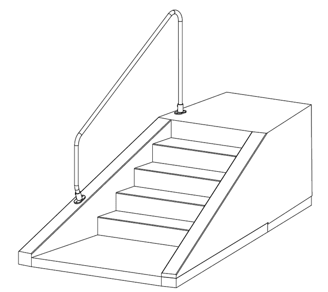

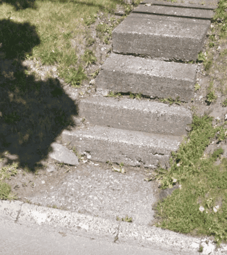

It is a handrail for a small 5-step (##\approx## 3 ft high) exterior stairway at my home. Mostly to help keep balance when people use the stairway (There was none for the last 70 years). No permits involved. Here is the old stairway:
Photo of an old concrete exterior staircase with worn, cracked steps set into grass and soil, with a shadow falling across the left side.
The new one (still made out of concrete) has an extra step and a wall on each side to keep the soil from tumbling down. The ramp will be bolted on one of the wall and it will look like this:
Line drawing of a concrete exterior stairway with five steps, flanked by side walls, with a metal handrail on the left side secured by base plates at the bottom and top.
  • Photo of an old concrete exterior staircase with worn, cracked steps set into grass and soil, with a shadow falling across the left side.
  • Line drawing of a concrete exterior stairway with five steps, flanked by side walls, with a metal handrail on the left side secured by base plates at the bottom and top.
Why use a bracket at all?
A little pre-planning and you could have cast some sleeves into your new slab. Suitable recesses could still be drilled.
Your design looks simple enough to bend up. Deicing salt is going to play havoc with any carbon steel. Expect a yearly maintenance chore if you don't use some sort of stainless. Match the stock to the strength, drill holes to spec for a tight fit to the stock, bend, set, caulk. Removable for inspection and no paint needed. Trade off: higher material cost.
Return: some kid balancing on your handrail which exists at the streetside, readily accessable to the public for foolish stunts, will not someday be surprised that the coat of paint over your structural rust at grade is inadequate to support his weight, leading to a potentially nasty meeting of said fool's head and unyielding pavement.
Any range of slip-fit designs, embedded pegs, ect, would seem preferable to the IMO anemic brackets being considered for something installed ostensibly for safety. Might not hurt to check with any possible legal ramifications of placing safety railings ect potentially in public right-of-way.

First, I'm usually not a big fan of things that cannot be dismantled (especially custom, one-of-kind, untested designs), but «pre-planning» is very difficult when the people designing the concept, building the stairway, building the handrail and installing the handrail are 3 different persons who don't know each other. When the builders like to «play it by feel» despite plans, it makes everything even more complicated. As the one designing, I «pre-planned» the possible deviations from the original plan and figured out easy ways to make the appropriate adjustments when connecting everything together.
I finally found the perfect shim. It is an exhaust pipe connector. It is designed to slide on a 1½" OD tube and its OD is very close to 1¼" pipe. The material is aluminized steel, so I have some corrosion resistance. Best of all, the length is 4" so I don't have to cut it, thus not exposing the steel core of the pipe. With a 4" length, the shim protrude about an inch from the top of the flange, giving a more pleasing transitional look than having a «small» tube going directly in a «large» flange.
I decided that I will put my zinc-rich primer on the handrail, put some paintable latex in between the handrail and shim to both prevent water going in and create a bond stronger than friction alone between them. I will then paint the handrail and flanges (in & out) separately and assemble them afterward.
The assembly will be a lot stronger than one might think:
  1. The flanges are not parallel;
  2. Fitting the handrail to the stairway demanded that I inserted a piece a wood to push the handrail ends away from each other to create the proper alignment. When I will remove this piece of wood (I had to used tie-downs to insert it; very tight), there will be a large spring force acting on the flanges, i.e. a lot of friction;
  3. Distorting the handrail to correct these misalignments ended up with the top end of the handrail being about 15° from vertical as it was intended. The play between the flange & the tube still allows this misalignment without creating a «crooked» look to the unaware eye.
For these reasons, I don't think it will be possible to simply pull on the handrail to remove it. Even if the setscrews weren't tighten. I really don't think the term anemic will apply to this assembly.
