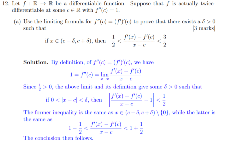

For this problem,
Handwritten-style typeset proof: a limit definition of f''(c) = 1 and the inequality |(f'(x) - f'(c))/(x - c) - 1| < 1/2 leading to 1/2 < (f'(x) - f'(c))/(x - c) < 3/2 on a punctured interval around c.
I'm confused by the implication from the antecedent ##0 < |x - c| < \delta## to the consequent. Should the consequent not be ##|f''(x) - f''(c)| < \frac{1}{2}## where ##\epsilon = \frac{1}{2}## (Since we are applying the definition of a limit for the first derivative curve)?
##\leftrightarrow |f''(x) - \frac{f'(x) - f'(c)}{x - c}| < \frac{1}{2}##
##\leftrightarrow |f''(x) - 1| < \frac{1}{2}##
I don't understand why they don't have ##f''(x)## in their expression. Does someone please know why?
Thanks!

For this problem,
Why? We already have ##f''(c)=1.## The statement is just a reformulation of this fact by using the definition of a derivative, choosing ##\varepsilon =0.5## and the definition of a limit with this given margin ##\varepsilon .## The proof goes:
\begin{align*}
1&=f''(c)\stackrel{\text{short for}}{=}\left. \dfrac{d}{dx} \right|_{x=c}f'(x)\stackrel{\text{def. of derivative of }f'}{=}\lim_{x \to c}\dfrac{f'(x)-f'(c)}{x-c}\\[12pt]
0&=\left(\lim_{x \to c}\dfrac{f'(x)-f'(c)}{x-c}\right)-1=\lim_{x \to c}\left(\dfrac{f'(x)-f'(c)}{x-c} - 1\right)\\[12pt]
&\left|\dfrac{f'(x)-f'(c)}{x-c}-1\right| \stackrel{\text{def. of limit at }x=c}{<} \varepsilon :=\dfrac{1}{2} \text{ for all } |x-c|<\delta\\[12pt]
&\substack{\text{definition of} \\ \text{the absolute values}}\quad\dfrac{1}{2}=1-\varepsilon <\dfrac{f'(x)-f'(c)}{x-c}<1+\varepsilon =\dfrac{3}{2} \text{ for all } c-\delta <x<c+\delta
\end{align*}
