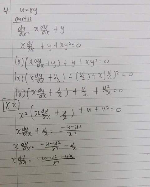

for this question, i sub u=xy and try to eliminate y in my working.. but how should i proceed since the term ux cannot be separated

I do not understand what you did. Your u-s and y-s look the same. Eliminate y by replacing it with u/x. Note that xdy/dx+y=du/dx, and xy2=u2/x.
