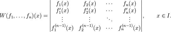

Let's start by looking at 33. Do you know how to use the Wronskian to show that functions are linearly independent in general?
Hey office_Shredder,
I am reasonably familiar with using the Wronskian to show that functions are linearly independent. I am more used to this form:
Where if W = 0 is true on an open interval I then the functions are linearly independent.
I don't completely understand the wronskian equation given in problem 33.
If you define [itex]f_i(x)=\text{exp}(r_i x)[/itex], [itex]1\leq i \leq n[/itex], what is [itex]f'_i(x)[/itex]? How about [itex]f''_i(x)[/itex]? What does that make the Wronskian for the [itex]n=3[/itex] case? Is there a rule for taking determinants where a column is multiplied by some factor that might help you here?
I understand where the matrix comes from now but I am not sure what method you are talking about for solving the determinant. Care to shed some light?
Use property 3 here. For example,
[tex]\begin{vmatrix} a & 2b & 3c \\ 4a & 5b & 6c \\ 7a & 8b &9c \end{vmatrix}=a\begin{vmatrix} 1 & 2b & 3c \\ 4 & 5b & 6c \\ 7 & 8b &9c \end{vmatrix}=ab\begin{vmatrix} 1 & 2 & 3c \\ 4 & 5 & 6c \\ 7 & 8 &9c \end{vmatrix}=abc\begin{vmatrix} 1 & 2 & 3 \\ 4 & 5 & 6 \\ 7 & 8 &9 \end{vmatrix}[/tex]
