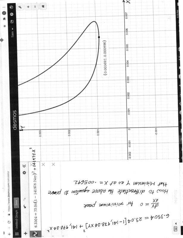

Summary:: Differentiate an equation to get the minimum peak
I have this equation:
6.3504 = 23.04 ( 1-141978.24XY)^2 + 141978.24X^2
I want to differentiate it with respect to X to get the minimum peak of Y
dy/dx =0
See attached file
Thanks for help

Thanks for your reply
Yes , we can put it in this form:
D=B(1-Axy)^2 + Ax^2
The graph of this equation depends on the constants D and B - but if we differentiate this equation with respect to x , dy/dx =0 , then the constant D will disappear though the graph depends on it ??
See the attached graph

This equation is function of x and y
Now how to get the minimum value of y ?
and this equation is independent of the constant D though the plotted graph shape depends on the constant D ?.
