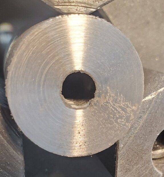

We haven't tried the diamond, but it seems the machinist managed to get a decent(ish) finish playing with speeds/feeds/cutting tools. Here is a before:
The 'fluffy' areas are where the crystal orientation is 'off', but after some testing he got it to this:

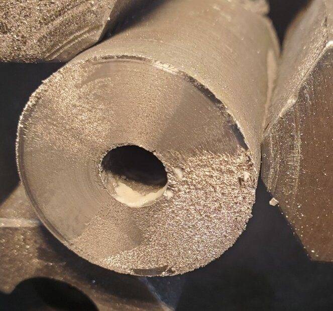

The issue now is with tapping the hole. The material was cast taking into consideration the expansion of the material as it solidifies (bismuth is one of those weird elements with this property), and even though we cast the theards, they need chasing afetr the fact. Unfortunately chipping is proving to be difficult to avoid yet again:
Good suggestions none the less, thanks for the tips!
Any other ideas on how to proceed from here?

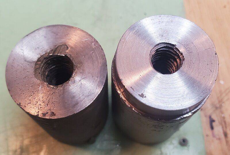

Well, here are the results of the heat treat and quench:

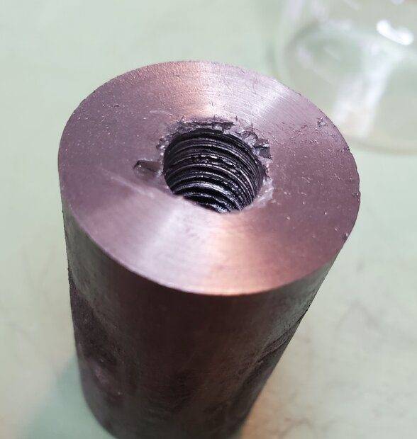

The piece on the right was heat treated and quenched while the piece on the left was faced and threaded as it came from the mold. As we can see there is a marked improvement on chipping with the quenched part (both are from the same melt/cast/mold).

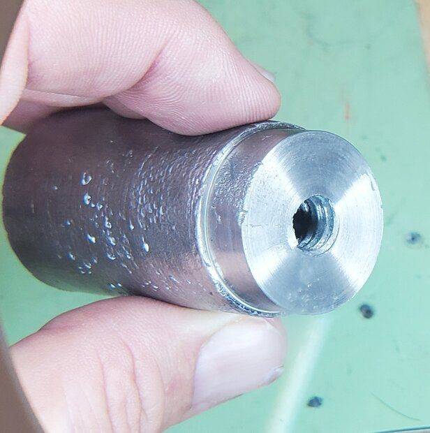

We brought the piece to within 20C of melting and held it for over 3 hours followed up by an immediate quench in water.
Although this is a big improvement, the threads are still experiencing an unacceptable level of chipping (may be a little difficult to see in this pcture, but there are a few 'chunks' missing on some portions of the threads down the borehole):
We plan on trying an oil quench since the specific heat is high, and boiling is above our material temp so less gas pockets from boiling so a better quench. We only need recrystallization of near surface for machining as the part is very close to its final form factor.
