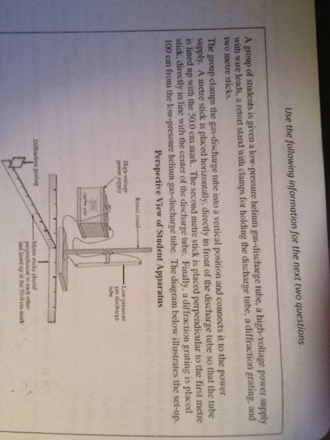

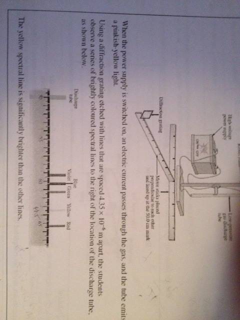

λ=xd/nl
Im having some difficulty with the variables, is d= lines/m? and n= 27? from the 50 mark to the yellow mark. then x would be 27*(4.35*10^-6) and l would be 100cm=1m ?
d is the distance between lines at the grating.
n is the order of the line. As you have just one line for each color (0 would correspond to light directed towards the tube), it is 1.
That looks like xd, but it has no units and where does the value of 27 come from?
Right
27 lines from thr 50 to yellow
Those are lines on the ruler, they are completely arbitrary (you could use a ruler with mm-marks as well). 13.5cm is the physical quantity, it does not depend on the type of ruler.
i just assumed that because of the each etched mark is 4.35*10^-6 apart, so d would be 4.35*10^-6 but x would be that times the 27 lines from the distance from central to the node.
So x =.135m d= 4.35*10^-6 l =1 and n= 1 so really the calculation is (.135*4.35*10^-6) ?
With units, yes.
Those lines ~4µm apart are at the diffraction grating, not at the ruler.
