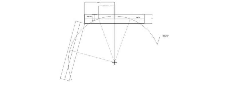

When I first did this type analysis, it was in the medieval ages, that is the only computers were main frames or micro-computers built and used by hobbyist. I used paper, pencil and a scientific calculator. It took about 1/2 a day to work out the basics and get initial results. Later on, as the world evolved, I used spreadsheet programs (SuperCalc was the first one I used, one of the early spreadsheet programs that you've probably haven't heard of). I've stayed with spreadsheet programs for this type of analysis, partly because I've never become comfortable using 3D CAD or solid modeling programs. Either 3D CAD or solid modeling programs should work, particularly if you need 3D graphics or animation. To my knowledge there are no rail or subway specific programs; I have seen several such animations and 3D models of station areas, track / train/ and adjacent construction that was done with off the shelf CAD and modeling programs. My personal opinion is that unless the problem under study is complex, they are not worth the time and cost of applying them, just because they can show pretty pictures. The problem is only 2D, hence I've never felt the need to do other than spreadsheets, of course your results may vary.
I've made a simple 2D drawing that shows the primary geometry. Hopefully I'll be successful in uploading it. This drawing is not to scale, the curve radius is much tighter, compared to the vehicle length than would be actual. Once you've got the basic geometry worked out, the various allowances become adds (or subtracts) from the offsets. In practice you can figure all the offsets as being parallel to the car's longitudinal center line. The several dimensions I've indicated are: Lcb/2 = 1/2 car body length, Lbogies/2 = 1/2 the distance between bogy centers, Offset mid = radial offset from the track center line at the mid car, Offset door = radial offset at center of a doorway from the track center perpendicular to the car body center line, W = car body width.
You probably have some specific designs and dimensions to work with, but some typical values I've encountered are vehicle lengths of 16 to 22 m, bogies spaced at approximately 60% of the vehicle length, curve radii on operating lines (not in yards and storage areas) greater than 200 m.

Dear DickL
Thank you very much for your valuable knowledge. Through reading your posts, I understand that I am talking to a veteran, so I admire your comments and notes.
I have got the concept and I will try to figure it out and write the cookbook by myself.
BTW your attachment had a scaling problem. It is to small to be read. Zooming also didn't work I think due to low resolution issue. Would it be possible to re-upload with a proper scaling?
