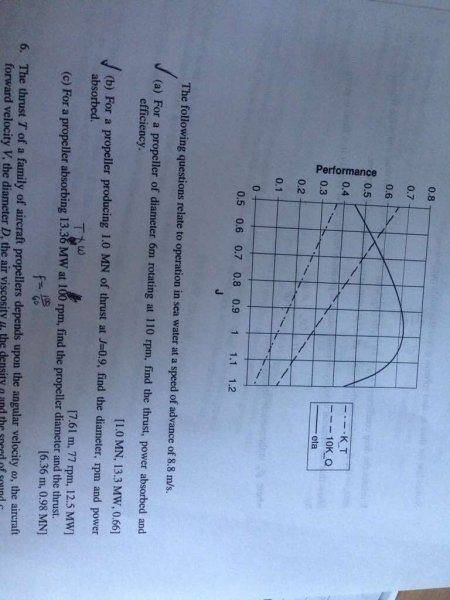

Hi, this is my first post, so sorry if this is posted on wrong section etc.
Do not worry about the initial part of dimensional analysis, that was fine - use Buckingham pi therem, but here's the prob...
Below is the question, I am stuck on being part C, however to show you guys what needs to be done, I've shown my working for parts a and b, and what I attempted for part C:

I suggest you rotate the images of the textbook so people don't have to read them sideways - or explain how they can be rotated with tools on the forum.
So, my neck is now kind of stiff, but I have a suggestion: It should be fairly easy to find an expression for, for instance, ##10 K_Q## in terms of ##J## (what is the equation of a straight line etc.).
You'd then have something like:
