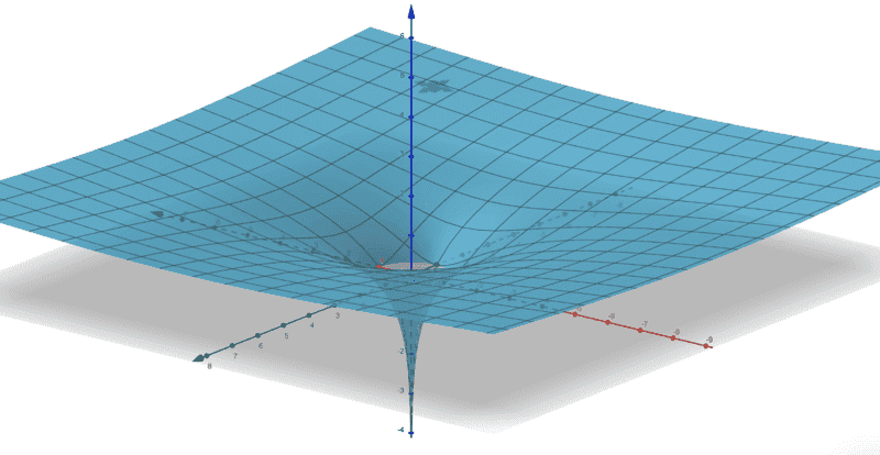

Hi
I have been doing a question on Lagrangian mechanics. I have the solution as well but i have a problem with the way the question is asked regarding dimensions.
The 1st part of the question says that a particle of mass m with Cartesian coordinates x , y , z moves under the influence of gravity on the surface
z = (1/2) In(x2+y2)
Now this doesn't seem right because the argument of a log should be dimensionless. Also the log of a number is a dimensionless number so the LHS of the equation has dimensions of length wile the RHS is dimensionless.
Following on from this comes my next confusion ; the Lagrangian which is given in polar coordinates involves a term containing (m/2) multiplied by (r dot )2 multiplied by ( 1 + r-2 ). This is adding 2 terms together with different dimension which is not allowed
Am i right that the question is written incorrectly or have i got something wrong ?

I'm not sure if this equation involves any units, as it might just be an equation of a surface. The graph of this equation is
I'm guessing that you're expected to use this equation as a constraint somehow

The equation for z is exactly as given in #1. There are no other constants mentioned

There must be units involved because to obtain a Lagrangian all the term involved must have units of energy. The kinetic energy terms involve time derivatives of position coordinates so z must have dimensions of position
You are perfectly right. The equation written is undefined. You cannot have dimensionful quantities as argument of a function, which is not of the form ##f(x)=A x^B##.

I don't think this sort of thing (dimensionless co-ordinates) is particularly uncommon, especially in applied maths. You could think of it as ##x = \tilde{x} / u_L##, with ##u_L## a suitable unit of length (e.g. ##1 \mathrm{m}##) and ##\tilde{x}## the usual dimensionful coordinate.

This example came from a maths exam. Maybe mathematicians aren't as concerned with dimensional analysis as physicists !
