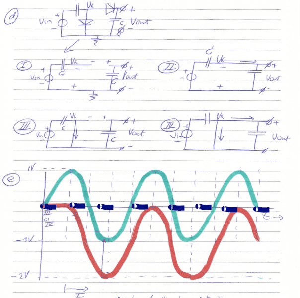

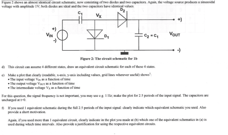

Model diode in reverse direction as an open, model diode in forward direction as a short.
In part e of the question, does the circuit stay in state 1 after it gets into state one or does it change states?

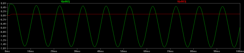

This is a simulation of the specified circuit, using real diodes. Red is Vout, green is Vx.

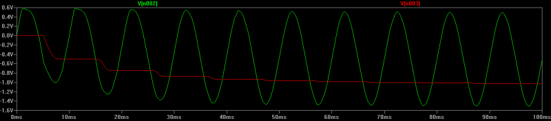

Now let's turn D2 around and see what happens:
