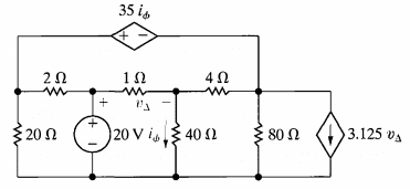

Say for example you had the following circuit.
Since it is hard to determine which source will have a bigger influence on current I am unsure of how I would determine which way the current would flow between each node.

In general, you may not be able to infer the directions of the final currents by inspection. The general way to handle these circuits is just to write the KCL equations (or KVL if you prefer), and solve for the node voltages, which then give you the currents.
So how would I determine the direction of the voltage drop without knowing the direction of the current due to the passive sign convention.

You don't need to assume anything about the currents. Just write the KCV equations as the sum of all currents leaving a node is = 0. If there is a current source connected to a node, you call that current + or - depending on if it is leaving or entering the node.
Can you write the KCL equations for the circuit that you posted, so that we can check your work? :-)
Its okay I have worked it out I just am unsure why the voltage drop over the 4 ohm resistor is from left to right.

What voltages did you work out for the left and right sides of that resistor when you solved the circuit?
-29V RHS and 10V LHS
Yeah, so that's why the current direction is the way it is. It's not intuitive to me either, but that's what solving the circuit does for us. :-)
