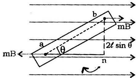

There was this section in my textbook describing Torque on a Bar magnet in a uniform magnetic field which states that the magnetic force m.B on one pole of bar magnet acts along the magnetic field. But that does not fit with the above statement that Magnetic force always acts perpendicular to particles.
Please Explain.

I am sorry. The m.B was actually multiplication of m&B.
Link to the original webpage
As you see in this figure, the Dipole is subjected to a force mB which is along the magnetic field.This is what is confusing me. No prior explanation was given in my textbook about magnetic forces acting in the direction of field(i thought they always act perpendicular). Does it happen only in case of dipoles? Because i am pretty sure that the force on an electron in Magnetic field would be perpendicular to it.
How does the book define m, exactly? It sure looks like to me like it's using m as the symbol for a fictitious magnetic monopole strength, analogous to electric charge.
Yes. Your right. The symbol m is described as magnetic pole strength in my textbook.
Edit: I read Wikipedia and found out that their are 2 kinds of Magnetic field H and B? I also read their are two models to describe magnetic field and that the H model was used to describe forces on magnets. I am confused now.
Edit#2 : I read some more. Correct me if i am wrong. The physically real magnetic field is because of moving charges or currents. The pole model is hypothetical but is easier to use. The magnetic force described in my previous post is also a consequence of this model that states that a pole in a magnetic field would be subjected to forces along the magnetic field something similar to electric charges in electric field. Hence the force m.B acting on the Magnetic dipole causes rotation.
That's sounding good. I think the most fundamental mistake you seem to have made was equating the force on an electrically charged particle with that of a magnetically charged particle. The latter don't seem to exist, but even if they do, the would not behave the same way.
