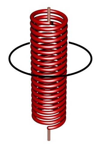

Example 5.9 in Griffiths's Introduction to Electrodynamics 4th shows us how to find B of a very long solenoid, consisting of n closely wound turns per unit length on a cylinder of radius R, each carrying a steady current I. In the solution, he goes on to explain why we don't have the radial and "circumferential" component of B. I get the explanation on the radial part but not quite understand the "circumferential" part...
The book draws an Amperian loop around the solenoid and writes
[tex]\oint \textbf{B} \cdot d\textbf{l} = B_\phi (2\pi s) = \mu_0 I_{enc}=0[/tex]
Why is the current enclosed equals to zero? I thought the Amperian loop enclose the winding which carries current with it? And why do we assume ##B_\phi## would be constant around the Amperian loop?

OK, let's do an Amperian loop around the solenoid:
Assuming that this is an ideal solenoid, i.e. the coils are tightly wound, what is Iencl, i.e. the net flow of current through the surface bounded by the Amperian loop?

To add to @ZapperZ 's explanation, evaluate ## B_{outside} ## in the formula ## \oint B_{outside} \cdot dl =B_{outside}(2 \pi r)=\mu_o I ##, so that ## B_{outside}=\frac{\mu_o I}{2 \pi r} ## ## \\ ## Compare the factor ## \frac{1}{2 \pi r} ## to the factor ## n ##, ## \\ ## where ## n ## =number of turns per unit length. ## \\ ## ## B_{z \, inside}=n \mu_o I ##. ## \\ ## A very loosely packed solenoid has ## n \approx 10/cm ##, while ## \frac{1}{2 \pi r} ## for ## r> 3.2 \, cm ## is a factor that is less than ## .05/cm ##. For this very conservative case, the magnetic field inside the solenoid is 200 x greater.

Isn't the [tex]I_{enc}[/tex]be a net I flowing upward/downward through the surface?

So you saying we still have ##B_{\phi}##, but it is negligible compared to ##B_{inside}##, so we just take it as zero?
Yes. That is correct.

The symmetry of the situation should convince you ##B_\phi## is constant.
Anyway, in my copy of Griffiths, he explicitly addressed your questions. Is there something about his explanation you didn't understand?

Everything is good now. Thank you!
